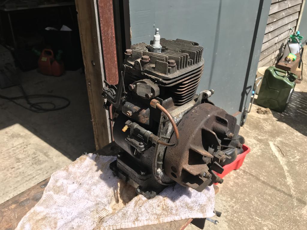

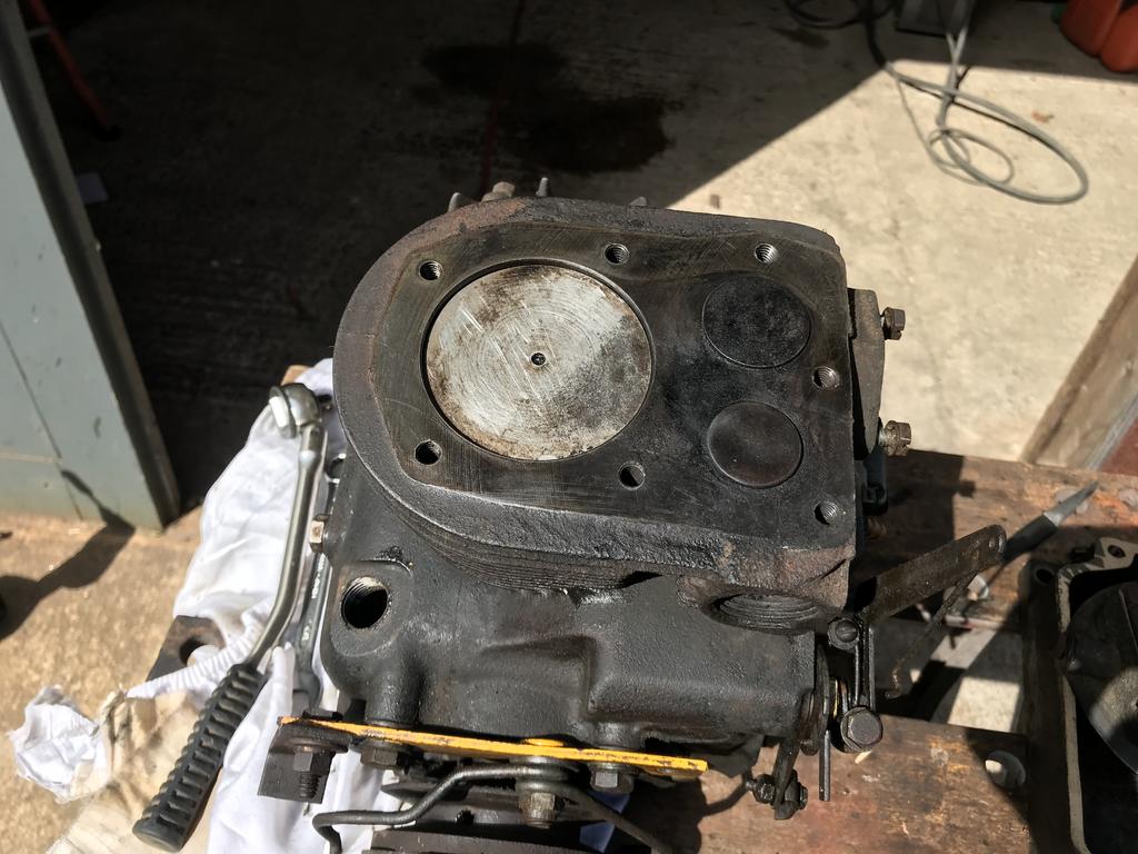

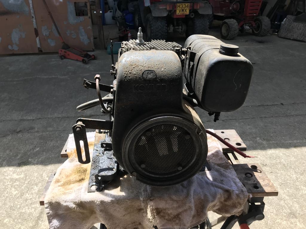

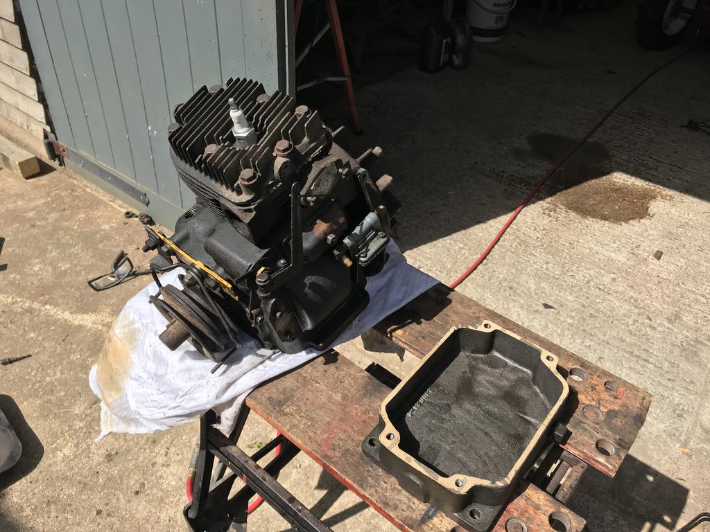

Cub Cadet 613 #1 Posted July 9, 2019 I have started work on my massey Ferguson 7e again and work has turned to the engine. We don't know if it runs and seen as i'm stripping the whole tractor down for a good clean it made sense to inspect the engine also. It was also a good time to make a new sump gasket as it leaked a lot of oil. After stripping it down some its apparent that one of the crankshaft bearings is a little bit worn, but after trawling the web i'm struggling to find what size bearings were used, we would normally measure the existing bearings but I haven't stripped it down that far yet. Any help would be appreciated as to where I can source this information. Thanks 1 Triumph66 reacted to this Share this post Link to post Share on other sites
