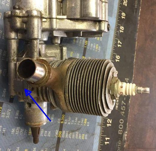

factory 487 #45 Posted November 8, 2019 On 11/6/2019 at 10:00 PM, JUST O&R said: got an old engine here might wok for jmb44 ( don't see your name on here so its just jmb44) before I take the gearbox off I will see if the boys can tell me if it will work ??? its a model b-II 102646 I think it has a different plug but need to see if crank is the same. not sure if it has a tapered shaft ??? The 'B' refers to it being a tank mount model, 'II' is for Compact II (0.85HP) this should have the improved bearings, the rest is the serial number. I'm curious to know if it has a model number or type stamped into the other side (arrowed). On 11/7/2019 at 12:46 AM, JDB44 said: Engine block has "Type 111" That is the standard model/type originally used for older Tiny Tigers. On 11/7/2019 at 12:11 PM, JUST O&R said: Boy that bench is a mess how do you find anything?? Got the gearbox off the back this morning , got a few pic's to see if the shaft is rite never taken a generator off yet. got two of them but still need to be restored . Let me Know if the crank is rite I'm in search of a cylinder with that will work with small plug hole. My bench is usually a mess too. So was my bench at work, much to the annoyance of the managers who would ask me to spent time tidying it up. What is wrong with the cylinder fitted? the 14mm spark-plugs are easy to find. David Share this post Link to post Share on other sites

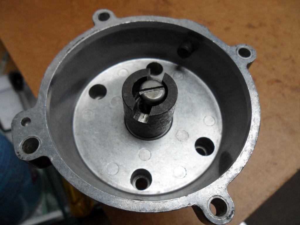

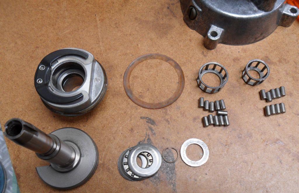

factory 487 #47 Posted November 8, 2019 9 hours ago, Wallfish said: I forgot about those! Maybe it's the chainsaw gear cases that all have the D shape shaft. JD's TT probably won't have the keyways. I've checked the parts lists for most common engine types used on chainsaws and most use the flat 'D' back-shaft apart from the early type 185 (and no I haven't checked one to verify). The tapered back-shaft with key-ways, I have found these on a Champ generator, I don't remember any keys fitted to either the back-shaft or coupling for the generator, pictures below of the back-shaft & coupling from my K.C. Wiggins Champ restoration. David Share this post Link to post Share on other sites
JUST O&R 237 #48 Posted November 8, 2019 David I WILL AD PICS BUT YES ITS A MODEL B II ser 102646. cylinder is good just trying to make it look like it should if I'm correct it should have a uy-6 in it???? like to make them as close as I can. but sometime we have to make due . I found a cylinder that will work for JD's generator but the crank has two keys in it . its taper but Ive never had one apart so don't know if it will work Share this post Link to post Share on other sites
JUST O&R 237 #49 Posted November 8, 2019 David missed that last post. so that shaft should fit the generator. the key-way does not mater? Share this post Link to post Share on other sites
