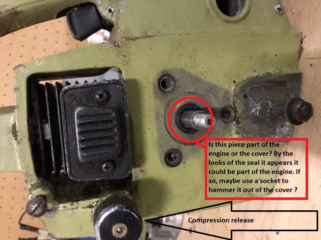

CNew 408 #1 Posted January 4, 2020 (edited) Ok, I’m stumped... I’m trying to remove a 20A engine from an old chainsaw and I feel like I’ve removed everything that keeps the engine situated in the frame/tank case. I can’t get the engine to budge at all. It looks like it should just slide out but it doesn’t so much as wiggle even with some gentle persuasion taps on the shaft from the opposite side. What am I missing? Edited January 4, 2020 by CNew Typo Share this post Link to post Share on other sites
Wallfish 716 #2 Posted January 4, 2020 I've never taken one apart so can only offer guesses and suggestions. I know there is a compression release but don't know how it's connected to the engine. You can see the tube or bar at the bottom of your last pic. Share this post Link to post Share on other sites
CNew 408 #3 Posted January 4, 2020 There is an oil seal on the shaft you pointed out. I haven’t removed it yet, didn’t want to damage it. Looks like I’ll probably need to pry that seal out and see if there is some sort of bushing or something that is holding the engine in. The pressure release thingy looks like it has room to clear the hole and housing without removing it first. There really isn’t any way to access it anyway without the engine being completely out. Definitely puzzling... Share this post Link to post Share on other sites
CNew 408 #4 Posted January 4, 2020 Ok, figured it out. I was able to pull the oil seal (probably can’t reuse it now) and sure enough there was a clip holding the shaft next to the bearing. Also, Wallfish you were right, the pressure release valve does have to come off first. There’s just barely not enough room leaving it in. I finally got a 7/16 deep socket that fit the narrow hole in the housing. Piece of cake after that and removing the clip... Share this post Link to post Share on other sites
