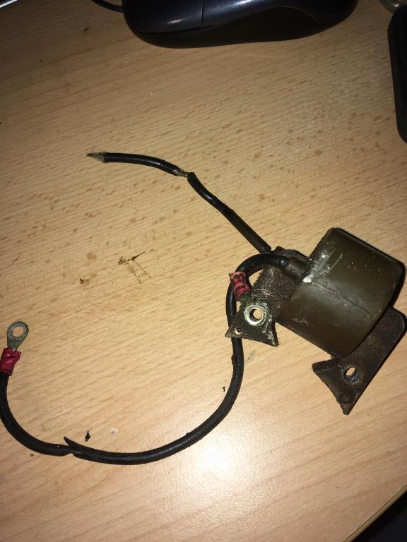

CNew 408 #1 Posted February 17, 2020 I’m sure this has been discussed before but starting a new thread to capture the knowledge. Is there a simple way to check coil function on the bench? I have an older style coil that is really beat up and I think has been exposed to some nasty chemicals or something because the plastic housing is gummy, soft and sticky. It also has a deep gash that broke through to the coil underneath. Not sure if it’ll function or is fixable. Share this post Link to post Share on other sites
JUST O&R 237 #2 Posted February 17, 2020 It doesn't look good . I had a coil tester years ago but when the stopped using points in the 80s sold it wish I had it now hindsight is 20/20 Share this post Link to post Share on other sites
CNew 408 #3 Posted February 17, 2020 Yeah, guessing this one isn’t going to be repairable. I’ll have to dig through my stuff to see if I have another donor coil like this older style. Share this post Link to post Share on other sites
factory 487 #4 Posted February 17, 2020 The only simple test is to use a multimeter (set to ohms/resistance function) to test the two coil windings, the secondary coil should have a resistance in the kilohm's range, but this will not tell you if the secondary has shorted turns. Coil testers can't be common outside of a repair shop, with a bit more electronic knowledge other test gear could be used. David Share this post Link to post Share on other sites
Wallfish 716 #5 Posted February 17, 2020 You probably don't want that coil on one of your collectables anyway. Replace it. Share this post Link to post Share on other sites
CNew 408 #6 Posted February 18, 2020 Yeah, looking to replace this one. The plastic is so squishy and sticky it’s nasty! Now I just need to keep on the lookout for one of these older style coils... Share this post Link to post Share on other sites
