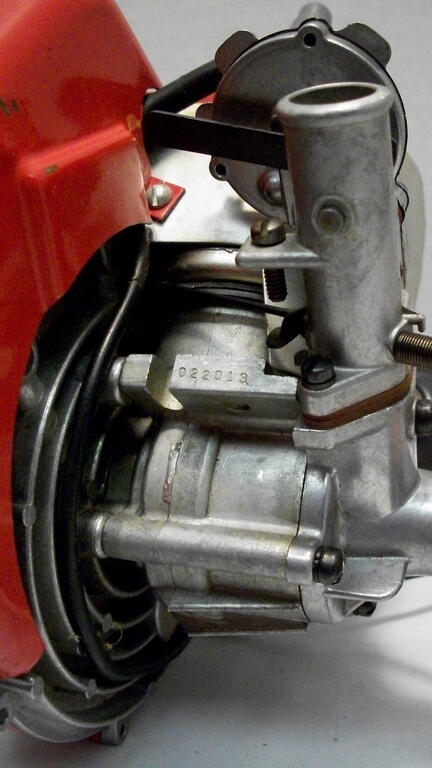

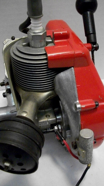

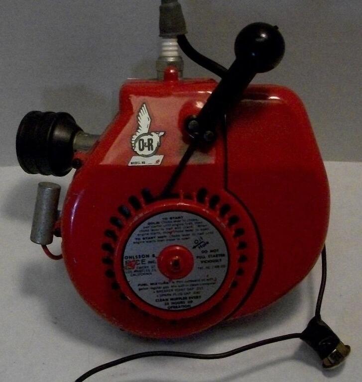

CNew 408 #1 Posted July 23, 2020 Next up is my Type 110. The internals on some of these earlier models are so different from the later engines. 1 Wallfish reacted to this Share this post Link to post Share on other sites
factory 487 #2 Posted July 23, 2020 Looks like a Comet tools engine, but it's not in the manual pictures I have saved from ePay. David Share this post Link to post Share on other sites
CNew 408 #3 Posted July 23, 2020 That’s what I thought too, looks like the ones for the Comet tools. I didn’t get this one off ePay... Share this post Link to post Share on other sites
Wallfish 718 #4 Posted July 24, 2020 The cooling baffle indicates it's probably from a circular saw. I don't remember ever seeing those on other tools. 1 CNew reacted to this Share this post Link to post Share on other sites
CNew 408 #5 Posted July 24, 2020 It also has the two notches cut into the mounting holes like on the circular saw. The carb also doesn’t have a hole for the hook screw for an air filter so that also seems like a circular saw set up. Share this post Link to post Share on other sites
factory 487 #6 Posted July 24, 2020 The grainy low resolution picture from a manual I have (not mine) gives; Type 96 for the circular saw, Type 113 for the chainsaw, Type 100 for the drill and Type 109 for the pump. Earlier ones may use a letter type instead (my pump uses a Model B for example). It probably is from a the circular saw, a later one without the extra long tube for the muffler and the added switch to compensate for the not having the remote handle mounted one. I just don't have any pictures showing the Type as it's usually inaccessible to take a picture. David Share this post Link to post Share on other sites
factory 487 #7 Posted July 24, 2020 You've just rebuilt a later Comet C/Saw, did you not note the engine Type (I can't see it clearly in any of your pictures)? I found this engine in my archived Comet pictures; with the correct stop switch, notches in the mounting flanges & no hole in the carb for the air cleaner screw, it's also a Type 110. David 1 CNew reacted to this Share this post Link to post Share on other sites
