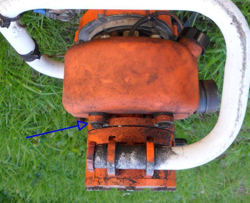

Wallfish 718 #4 Posted July 25, 2020 Just a single fuel line to the carb. The most common issue for a no spark condition is the points. They're located under the flywheel and under that little panel. Clean the contacts well and also clean the spring where it contacts the little post. This is a pic of the tank although the trimmer is different Share this post Link to post Share on other sites
factory 487 #5 Posted July 26, 2020 That explains what Danarm were importing & rebranding, it's a Grow Gear trimmer with a planetary gear box (not the same as Orline, etc), see the Grow Gear advert part way down the page here; The fuel tank is plastic & fits the two smaller holes on the gearbox. My later Grow-Gear for comparison (has different handle but other-wise the same). David 1 Rennie reacted to this Share this post Link to post Share on other sites
