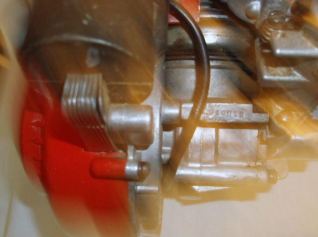

1olddog 3 #1 Posted September 2, 2020 (edited) I just bought an O&R that was from an r/c boat ,probably the Octura White Heat V. It has an eight pipe exhaust for a boat.I've cleaned it up and ordered a pull starter knob for it.The O&R 1 HP decal is worn off and also the label on the pull starter. Is there anyone that makes decals for vintage motors. It has model II on it but looks like a B was stamped over it.There's also an A stamped over to the right of the model number.On the other side of the engine is stamped 014811. There may be either a B or an 8 at the beginning of number.Don't know what I'll do with it as it's not fast enough for my r/c boats.May just sell it to fund another project.Here's a pic of the boat it was probably in. Edited September 2, 2020 by 1olddog 1 CNew reacted to this Share this post Link to post Share on other sites
factory 487 #2 Posted September 4, 2020 On 9/2/2020 at 8:44 PM, 1olddog said: I just bought an O&R that was from an r/c boat ,probably the Octura White Heat V. It has an eight pipe exhaust for a boat.I've cleaned it up and ordered a pull starter knob for it.The O&R 1 HP decal is worn off and also the label on the pull starter. Is there anyone that makes decals for vintage motors. It has model II on it but looks like a B was stamped over it.There's also an A stamped over to the right of the model number.On the other side of the engine is stamped 014811. There may be either a B or an 8 at the beginning of number.Don't know what I'll do with it as it's not fast enough for my r/c boats.May just sell it to fund another project.Here's a pic of the boat it was probably in. It looks like a Model B with an X stamped over it to me (to convert it to a Model A), a Model B has a base mount gas tank, a Model A would have a standard round gas tank that could be fitted anywhere. Serial #014811 would date from somewhere between late 1961 to early 1962, sorry I can't give a more accurate date for these earlier engines, after June 1967 they had the date coded into the serial number. The engine is a 3/4HP version, it would not had a decal for this as no other versions were available at the time this was made. These are the decals it would have had (from engine #014035); The V8 style exhaust was supplied by Octura Models, the 60° version is for the White Heat V and the 90° version is for the White Heat X. David Share this post Link to post Share on other sites
