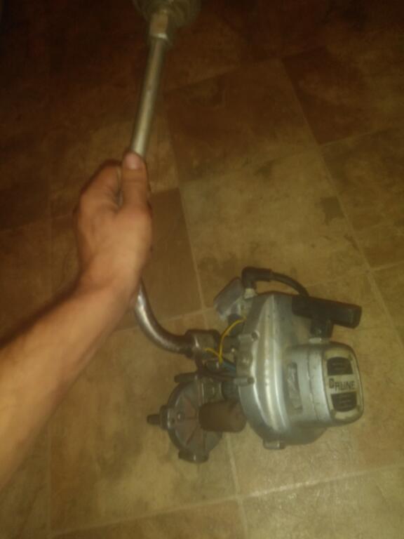

Wallfish 718 #2 Posted September 25, 2020 That's a newer style Chicken Power. Used to power a bicycle on the front tire but you're missing some pieces. Is that the ? Share this post Link to post Share on other sites
Cali 0 #3 Posted September 28, 2020 Can u tell me what all im missing and the moters froze i broke the pull cord trying to get it to turn Share this post Link to post Share on other sites

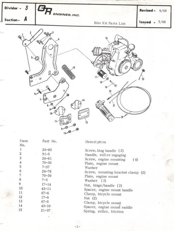

Wallfish 718 #4 Posted September 28, 2020 It could be the gearbox that's locked up. The old grease inside them gets hard as a rock. You will need to disassemble the engine and gearbox to find out which it is. Here's an older engine chicken Power thread which shows the parts. Yours is a newer engine so the gas tank would be different but the frame that mounts to the bicycle fork is basically the same Share this post Link to post Share on other sites
Cali 0 #5 Posted September 29, 2020 I have taken the entier thang apart and can't find eny reason for it to be froze the greese is ok in gear box I paid 25bucks is that a good deal Share this post Link to post Share on other sites

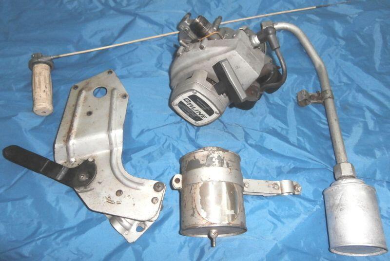

factory 487 #6 Posted September 30, 2020 The starters are really fragile, forcing them to try & turn a stuck engine or gearbox will usually end up with a broken starter spring or cord. If the engine is stuck, add a teaspoon of oil to the inside of the cylinder & leave it for a few days or a week, then remove the starter housing and try turning the engine with the flywheel, I've freed many this way, including one where someone stuck a hole through the piston trying to hammer it. Another thing to note, never unscrew the cylinder if the piston is stuck as a broken con-rod will be guaranteed. The missing parts are the air cleaner assembly, gas tank, twist grip throttle control and the bike mounting kit. $25 is a bargain, they normally sell for $100+ for an average condition one, to a lot more for mint boxed ones. David Share this post Link to post Share on other sites
factory 487 #7 Posted September 30, 2020 Starter rebuild info for the model 13B engine here; This shows the bike mounting kit & other parts, the mounting kits were supplied with a selection of different parts to suit different bike frames. The parts list for the earlier version with standard O&R exhaust & engine mounted gas tank. David Share this post Link to post Share on other sites

Cali 0 #9 Posted October 1, 2020 12 hours ago, factory said: The starters are really fragile, forcing them to try & turn a stuck engine or gearbox will usually end up with a broken starter spring or cord. If the engine is stuck, add a teaspoon of oil to the inside of the cylinder & leave it for a few days or a week, then remove the starter housing and try turning the engine with the flywheel, I've freed many this way, including one where someone stuck a hole through the piston trying to hammer it. Another thing to note, never unscrew the cylinder if the piston is stuck as a broken con-rod will be guaranteed. The missing parts are the air cleaner assembly, gas tank, twist grip throttle control and the bike mounting kit. $25 is a bargain, they normally sell for $100+ for an average condition one, to a lot more for mint boxed ones. David If i can get it unseized what do u thank its worth do u thank someone might trade me for a newer bike moter maybe is it verry sought after Share this post Link to post Share on other sites
