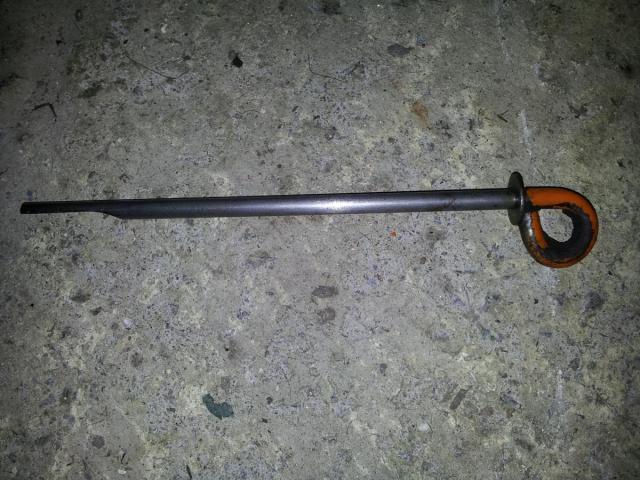

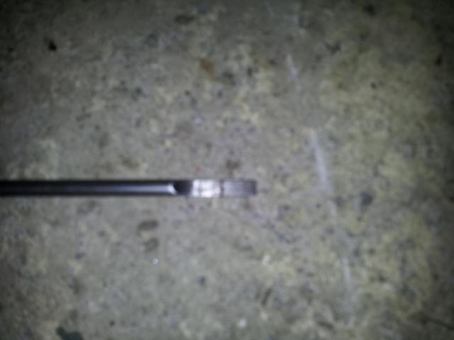

Vig 1 #9 Posted June 10, 2014 Saw this post after trawling the net for other info measurements are:- 118mm from the washer shoulder to the end part (sump0 dipstick The rod diameter is three sixteenths the rod is cut to form a half moon in profile at dipping end to a total length of 20mm there is a line halfway at 10mm ... this i take to be the median oil level.. this bantum is new to me as well and i am not familiar with the measurement yet either regards Vig 1 ChrisE reacted to this Share this post Link to post Share on other sites
ChrisE 0 #10 Posted August 20, 2014 Thanks Vig! I will use you measurements this weekend. I polished the valves and corrected the clearance. The intake valve was not opening completely. It has so much more power now. Now I have a new problem; the key sheared in the keyway and cracked the flywheel. I am guessing it is cast iron? How can I repair this? The keyway is damaged as well. Regards, Chris Share this post Link to post Share on other sites
