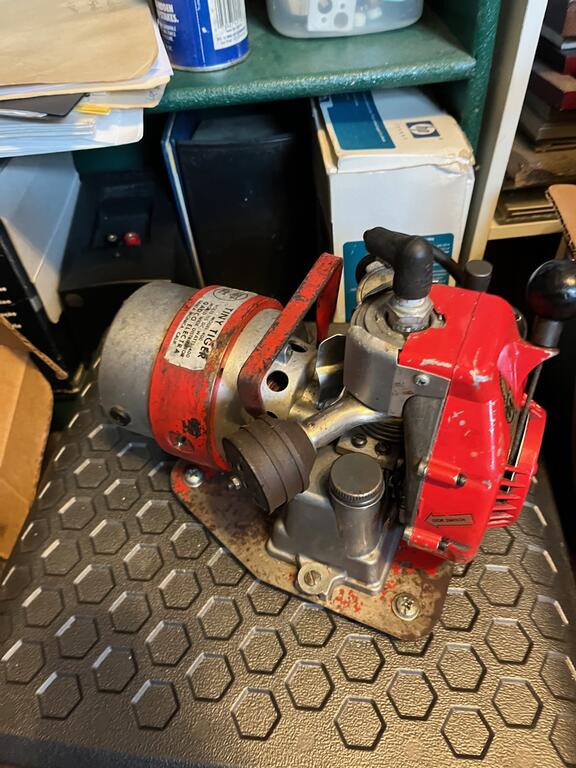

Wallfish 718 #27 Posted January 27, 2024 TT 400. No where near as common as the 300 or 350 are. Pulled this one out to copy the base for the earlier 300 but now it's going to be the next one up for a rebuild too. Share this post Link to post Share on other sites
CNew 408 #28 Posted January 27, 2024 Band strap turned out great! You’re cruising through these engines. Not sure I’ve seen that particular TT, very cool! 1 Wallfish reacted to this Share this post Link to post Share on other sites

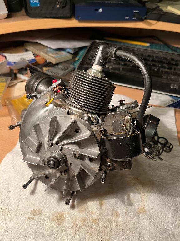

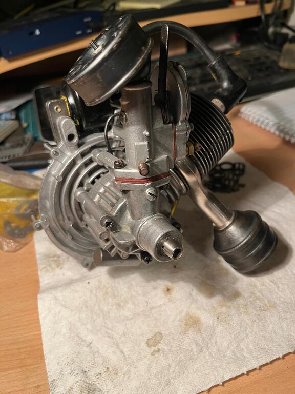

Wallfish 718 #29 Posted February 8, 2024 Well here's another one rebuilt. Used the so called "unserviceable" shaft that was serviced in the other thread about changing the shaft. And the muffler from the muffler bluing thread. Recoils and housings will need to wait as I have 2 or 3 that need paint and new decals. Maybe in the spring. Share this post Link to post Share on other sites

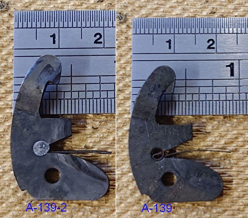

Wallfish 718 #31 Posted February 8, 2024 6 hours ago, JUST O&R said: recoil dogs for the old ones there like hens teeth Have 2 sets of NOS hens teeth Plus there's a couple / few in the hardware pile that have springs missing. I'm thinking solder on new pieces for springs on those. Maybe cut some thin strips of copper sheet metal for the springs. Did you make air baffles before? Thinking about giving that a shot too but it's going to be difficult to get them to look original or somewhat close. Wondering if I can make some kind of a mold out of pipe and steel to press them with a hydraulic jack or hammer it hard together. IDK. Another crazy experiment that sucks up time but the challenge of it is most of the fun. Share this post Link to post Share on other sites
