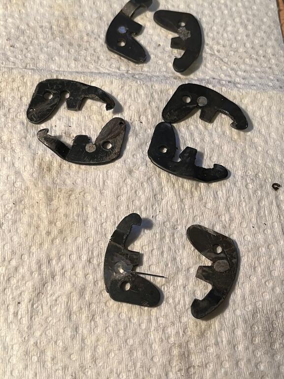

Wallfish 700 #1 Posted February 19, 2024 Well, got one done anyway. Took much longer to do than anticipated. I cut some of that blue spring steel I ordered for making the carb springs. The first stuff I ordered was too thick for the carb springs and it finally found a purpose. Sliced a long thin piece off then heated and bent the edge of it into a circle to fit in the dogleg hole. Drilled out the old stuff. Put the new spring in place then dropped solder in. The bubble of solder was big so I also hammered it so it would stay very tight. Filed off the remainder and cut the spring to length. Seems to work well. UGH, only 7 more to go! I like that gun bluing stuff so I'll probably clean them all up and coat them with that too. 3 1 CNew, factory, K-TRON and 1 other reacted to this Share this post Link to post Share on other sites
