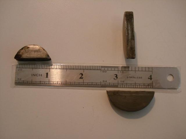

squonk 71 #13 Posted May 23, 2014 Speaking of axle keys. I bought my 73 12 from the original owner. He had every receipt that he ever got for it. Nothing was noted about replacing an axle. I replaced the puny stock rear hubs with a pair from a 520. The axle keys were 2 different sizes. I had to use a #15 and a # 22 I got hardened keys from McMaster-Carr. http://www.wheelhorseforum.com/topic/46580-a-tale-of-2-keys/?hl=%2Baxle+%2Bkeys#entry429788 Share this post Link to post Share on other sites
