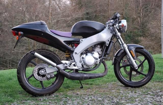

This is a project not related to anything garden machine-y. It's what Martin77 and I are working on at the moment.. Martin77 is a fairly well renowned tuner of two-stroke motorbikes, and he also makes exhausts for the same.
I ride a small bike anyway (a little Yamaha RXS 100 from 1989, for anyone that's interested) but I wanted something a bit more sporty. Because I am short - or rather, I have stumpy legs - I needed something that wasn't too tall. Riding a bike when you can only touch the floor on tiptoes isn't great fun.
So Project Pipsqueak was born...

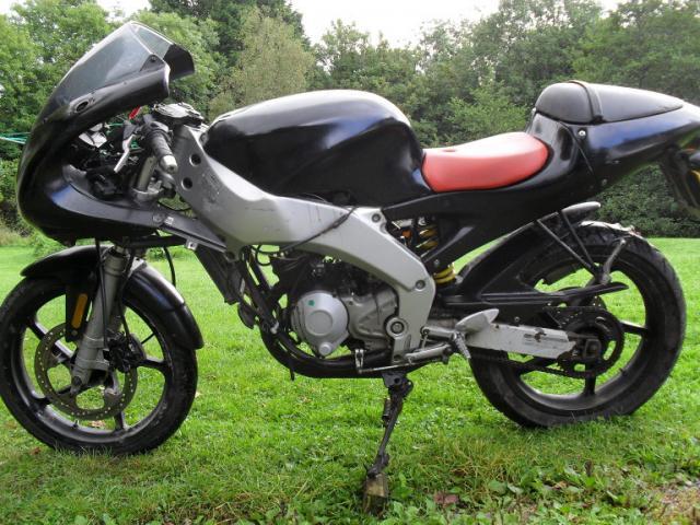

We found a suitable chassis: An Aprilia RS50. This kind of learner legal bike is bought by 17 year olds and ragged to death, and true to form it was in pretty poor shape when we got it - Martin traded a set of exhausts for it (about £200 worth).
Its engine was knackered - the top end anyway - the last kid who had run it had used a big bore kit, but then slapped the standard 50 head on it, and not done anything with the carburation, resulting in a holed piston. So we removed the engine and sold it - there was a decent crank in there, and we sold the carb too, and some fairings we didn't want.
We purchased an engine from a Yamaha TZR125 and shoehorned that in - rather a neat fit! I cleaned up the frame and swing arm and had them powder coated (for free at the factory Martin's brother works at).
Martin has amended the front end, altering the clocks, adding new brackets and a single headlight, and we will change the bars so that they aren't such a stretch for my stumpy arms.. and of course he made a pipe for it!

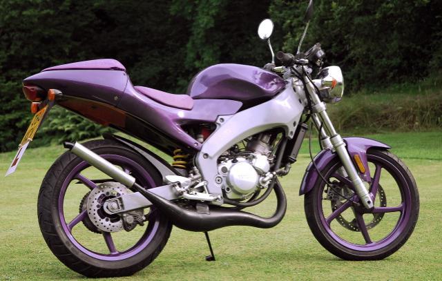

It runs really nicely now, after a few issues with powervalve timings, has passed an MOT and just really needs the bars sorting out, plus all the cosmetic stuff - painting! It will be purple all over, if I have my way, apart from the bits we had coated.
Total cost is under £400.

That's a nice project, good value for money as well for an all in cost of £400...    Is the fairing staying off? The bike looks better without one :)

What a daft rule Koen.. a hangover from the days of motorised bicycles I guess. Insuring it here would be problematic; I have had to use an online insurer that asks for engine number and CC, cos if I had to phone for a quote I would have to tell them it was modified. It's legit - I changed the V5 - but the insurance would be a small fortune otherwise.
Nah, I think Pipsqueak has stuck - I am not generally a fan of "naming" vehicles, but my other bike is "bob" just because it's easier to say than "the rxs".
Martin says it will look like a flying blackcurrant milkshake. Like that's a bad thing! He has just changed the handlebars for me cos the clip-ons were just too much of a stretch. All his porting work is done with a flexi-tool - now that's a bloomin useful thing to have in your workshop.
