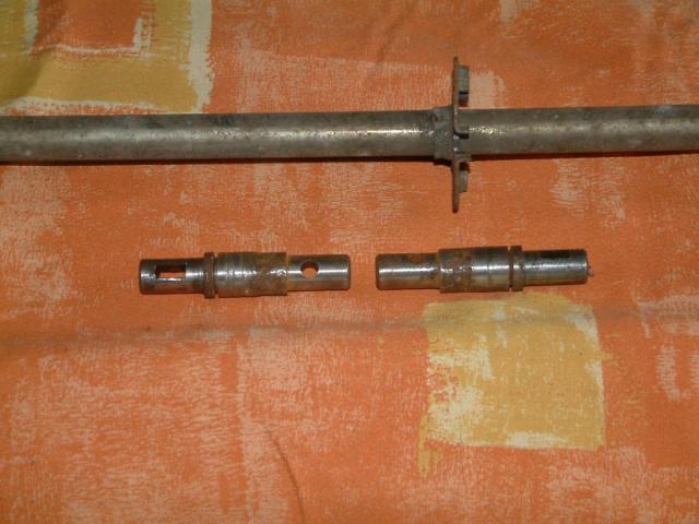

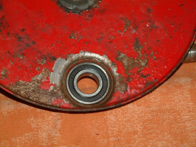

Stormin 4,458 #1 Posted September 3, 2014 Last year I got a Wheel Horse lawn sweeper. Not that I've got a big lawn, but I cut the grass on the village green. That's number 3 grandson, not me. While doing a neighbour a favour by cutting, then sweeping, her very large back lawn/field, one of the brush spindle bearings collapsed. On stripping things down, I found the other bearing not in the best of health either. I knew that getting OE bearings could pose problems, I decided to modify to metric bearings. The difference in the outside diameters of the OE bearings was 2 thou. Two metric bearings were procured with 35mm o/d. These tapped nicely in to place. The inside diam is greater than the brush spindles end inserts. You can see where the worn bearings have scored the inserts. The plan is to turn up two sleeves, that will be heat shrunk onto the inserts, then turned down to suit the metric bearings I/d. 1 Ian reacted to this Share this post Link to post Share on other sites

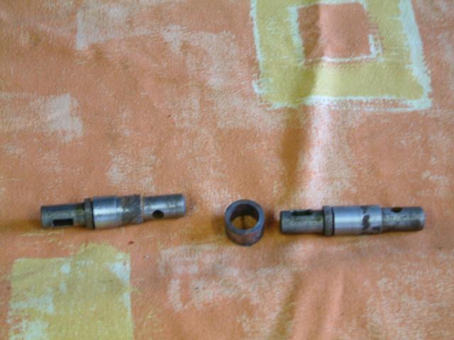

Stormin 4,458 #6 Posted September 4, 2014 Had an afternoon familiarising myself with the new lathe. Here's the result. Skimmed up the inserts for the brush spindle and turned a couple of sleeves. Finished insert on left. Sleeve ready for fitting on right. The sleeves were heat shrunk on the inserts. This was done by putting the inserts in the freezer and heating the sleeves on a camping stove. Complete assembly was then put in the lathe and the sleeve machined down to fit the bearing. And they do. Now all I've got to do is put everything back together and see if it will work. For reference for anyone going to do this mod, the bearings are 35mm od x 17mm id x 12mm. Cost me £6 the pair. Share this post Link to post Share on other sites

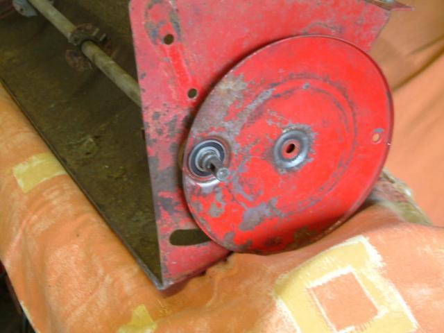

Stormin 4,458 #13 Posted September 16, 2014 Used the sweeper for the first time yesterday. Working great, as good as new, until a wheel came off. The wheels are held on by just a circlip, those horse shoe type. Hub cap still in place on the wheel and circlip inside that. Nothing lost. Replacing the wheel and clip, I thought the clip a bit loose, though tight to put on. Squeezed it up a bit in the vice, replaced and off we went again. Then the wheel came off again. This time the pawl that's inside the brush spindle drive gear had disappeared. Inside the wheel are two plain bearings and on close examination, I noticed the outer one a fraction proud of the wheel. This would account for the clip being hard to replace and not seating in the groove as it should. I tapped the bearing in until it was just under the outside of the wheel and the circlip groove just cleared. I removed the opposite wheel and used the pawl from that side, to make a replacement for the missing one. After some judicious use of a file and micrometer, a replacement was fitted tonight. All seems to be working OK, but Share this post Link to post Share on other sites
