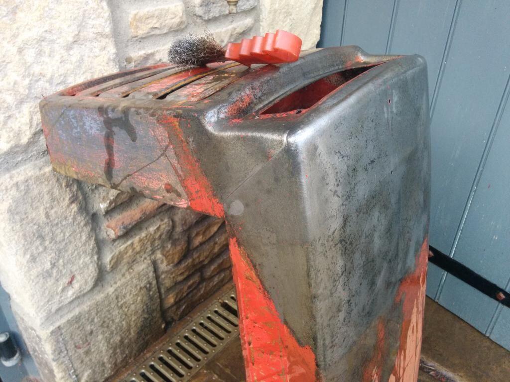

meadowfield 1,901 #5 Posted October 1, 2014 Norm sounds like you have the wire the wrong way round Anode is + and needs to be the metal you don't want to clean. -ve (cathode) goes to the piece you want to clean... You will make your wheel rustier if you leave it too long oh, and get some pictures up Share this post Link to post Share on other sites
Stormin 4,458 #6 Posted October 1, 2014 My mistake, Mark. Error rectified. Share this post Link to post Share on other sites

meadowfield 1,901 #9 Posted October 3, 2014 heres my hood after a few days in the tank, just turned it over to cook the over side Share this post Link to post Share on other sites
