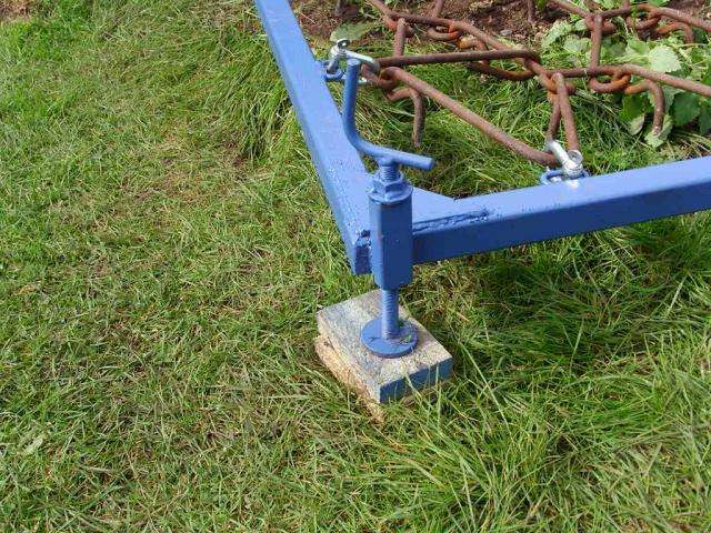

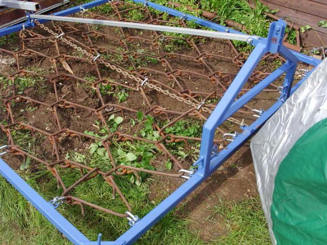

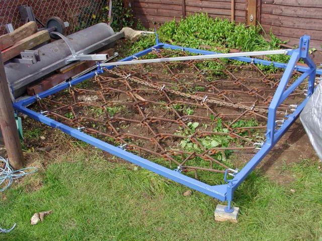

Thought I would just show you these that I have made in the last week.
I had some harrows that were just towed which is a pain as I would have to put them on a trailer all the time so I thought I would make life easier by putting them in a frame.
The frame is 40x40 box and I also made some legs so it isn't always on the ground. The chain in the middle to stop them sagging is the original towing chain. The size is 2 meters square. When I looked on the auction site they were going for £ 250- £500 mine cost me about £50 plus my time. I only had to pay for the box and the shackles everything else has been kicking about here and the harrows were in a hedge surplus to requirements.
Paulpost-109-0-81277100-1412521517_thumb.jpgpost-109-0-94969300-1412521531_thumb.jpgpost-109-0-00904200-1412521546_thumb.jpg

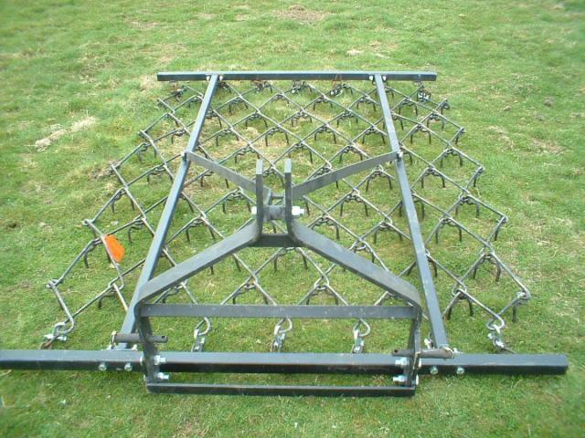

Hi
In answer to your question Norm, that's the way they came off the pole when they were trailed and I have checked and been told they can be used either way. Here is  some more the same way.
Paul
