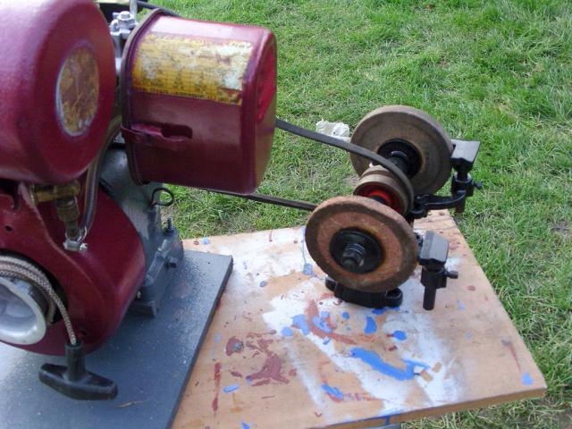

paul 64 #1 Posted November 19, 2014 Hi All, Have got another engine, No not out the normal barn. Problem I have is I have never seen one before, so know nothing about it. The stickers on the fuel tank say BSA POWER UNIT. I found some markings on the bottom of the block saying 120-RG-3127. Can anyone identify it by these numbers and letters so I can try and get a handbook for it? It didn't work when I got it, would turn over but recoil rope wouldn't go back in, had a look and the tension spring has rusted through also there was no compression so took rocker cover off and found a valve stuck and push rod flapping in the wind. I have sorted the valve now so I have compression. Havent got a clue about any settings though yet. Paul Share this post Link to post Share on other sites

paul 64 #11 Posted December 20, 2014 Hi All, The BSA is now finished and powering a bench grinder. Just got to sort some decals and a proper base. Paul Share this post Link to post Share on other sites
