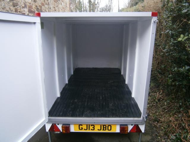

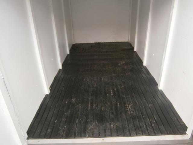

pmackellow 2,738 #36 Posted February 1, 2014 Rubber matting now fitted to floor, expertly trimmed to fit by my dear wife... she's a good girl Share this post Link to post Share on other sites
Stormin 4,458 #37 Posted February 1, 2014 Looks good! Just a thought. Handy for washing out but beware of water getting underneath and rotting the floor. Share this post Link to post Share on other sites
pmackellow 2,738 #38 Posted February 1, 2014 Yes I will check that every so often, these mats (stable mats) are great but I know that they can hold water underneath, so it will be lifted regularly to check out the floor... Share this post Link to post Share on other sites
Stormin 4,458 #39 Posted February 1, 2014 The floor will most likely be treated already, but a good coat of floor paint wouldn't go a miss. Share this post Link to post Share on other sites
pmackellow 2,738 #40 Posted February 1, 2014 Yes it has been treated already so its not a mat on bare wood... Share this post Link to post Share on other sites
Stormin 4,458 #41 Posted February 1, 2014 What's it's load weight capacity BTW? Share this post Link to post Share on other sites
pmackellow 2,738 #42 Posted February 1, 2014 750kg Gross Trailer weight and the trailer empty weighs 250kg, so 500kg carrying capacity, that should be enough for what I want to carry in it Share this post Link to post Share on other sites
simar kid 22 #43 Posted February 1, 2014 I don't want to interfear with your trailer as you have probably thought it all out but the rear door is good but if it was hinged at the bottom you could use it as a loading ramp. very nice all the same. from jealous simar kid. Share this post Link to post Share on other sites
pmackellow 2,738 #44 Posted February 1, 2014 Had thought of that one John, the door did not look strong enought to take the weight of a tractor so I will use the ramps I already have and just have the door as side opening and not weight bearing !! Share this post Link to post Share on other sites
simar kid 22 #45 Posted February 1, 2014 I knew you had thought about it was not sure how you planed to load it but its as clear as cristal now. well done Share this post Link to post Share on other sites
pmackellow 2,738 #46 Posted February 1, 2014 Anyway no need to be jealous John theres nothing wrong with your covered trailer it does the job and I know you are rightly proud of how it all turned out I was thinking along the lines of a frame and cover on our Ifor Williams trailer until the box trailer popped up on that well known auction website... Share this post Link to post Share on other sites

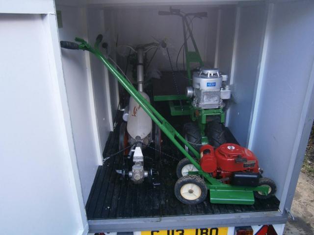

pmackellow 2,738 #47 Posted February 16, 2014 Trailer saw its first load today, seemed to cope ok... Share this post Link to post Share on other sites
simar kid 22 #48 Posted February 19, 2014 where s my post gone. never mind I will try again. your trailer looks clinicaly clean paul and wendy,like an operating theatre Share this post Link to post Share on other sites
pmackellow 2,738 #49 Posted February 19, 2014 Don't know where thoise posts went John, the trailer won't stay that clean for long !! Share this post Link to post Share on other sites

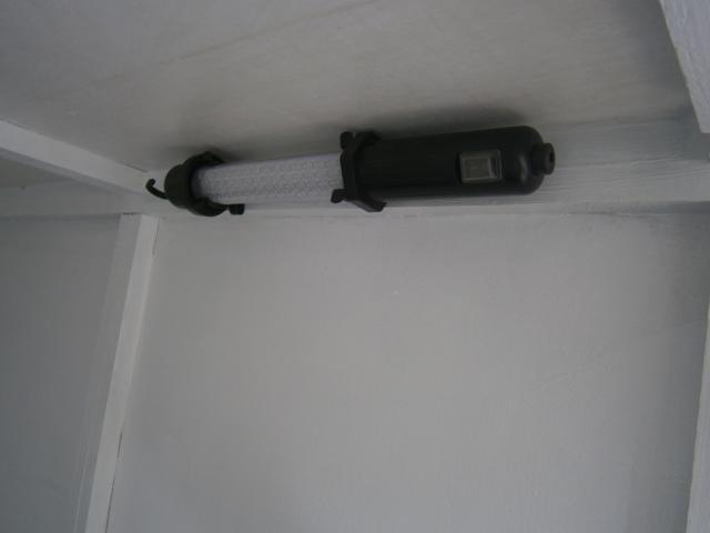

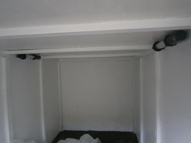

pmackellow 2,738 #50 Posted March 30, 2014 Finally got round to fitting lights inside the trailer yesterday, nothing flash just a couple of rechargeable LED lamps on Terry clips... Share this post Link to post Share on other sites
