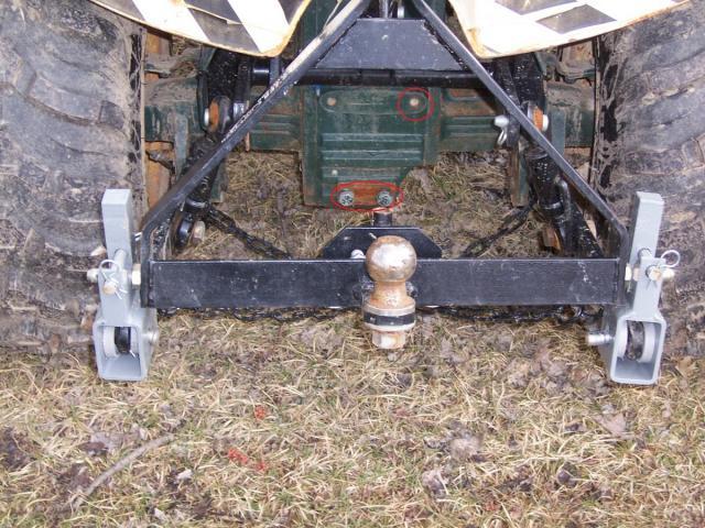

OldBuzzard 186 #9 Posted February 11, 2015 ... If you want to put it on the HT20D or HDT1000 I would have thought that it would not be too difficult to get the correct length shaft made, assuming you have the ends. It is hard to see how it fits on the tractor from the auction pictures. It would be great if you can post some pictures once you have it on the tractor. Iain It uses the same shaft as the tillers. As for mounting, it looks like it uses the three threaded holes circled in this pic: 2 Triumph66 and slf-uk reacted to this Share this post Link to post Share on other sites
