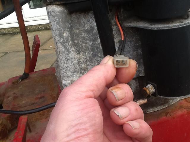

the showman 4,074 #1 Posted March 1, 2015 Got a Briggs engine in my B115 and need a bit of info on the wiring. Model 284707, type 1186-e1, code 980821ze. Can someone tell me where the red and black wires go and the single black go, see photo Share this post Link to post Share on other sites
meadowfield 1,901 #2 Posted March 1, 2015 Red is charge, black is kill. I might have the opposing connextor... But would need a clear picture. I use the same connector types on all my rewire jobs so that engine lifts out easier. Share this post Link to post Share on other sites

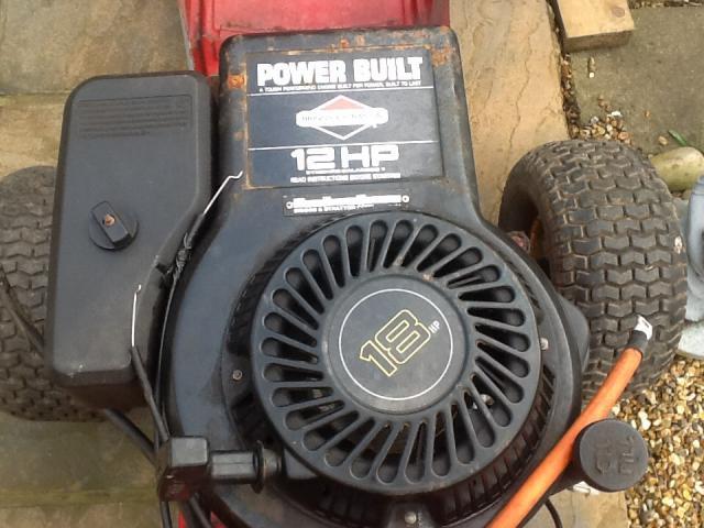

Anglo Traction 1,016 #3 Posted March 1, 2015 I'll bow to Mark's knowledge on the wiring. What confused me is the Engine numbers are for a 12hp 1998 engine and maybe should 284707-1136-e1 ?. Also the B-115 was last built in 1984 I believe (12-11BP02) and had an 11hp 253707 motor. So we assume it was re-engined at some stage. Parts diagram for that Tractor model shows the Red and Black (with connector) coming from the Dual Alternator which possibly supplies lights and Battery charging separately?. Afraid my Briggs Workshop Manual only goes up to about 1982. I'll see if I can find a proper Wiring Diagram for a B-115 and go from there. Share this post Link to post Share on other sites

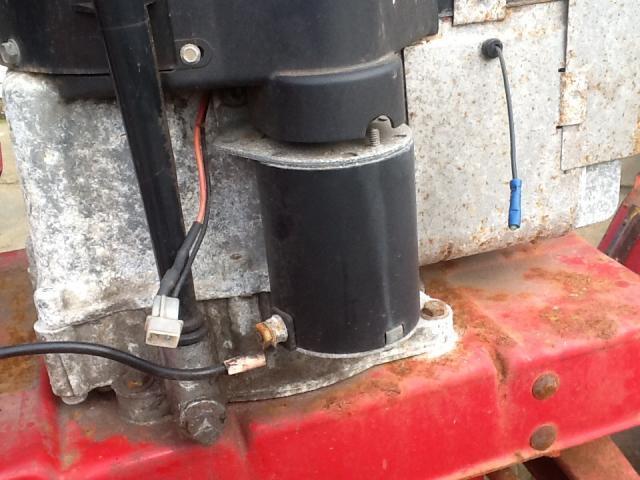

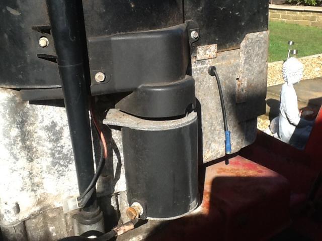

the showman 4,074 #4 Posted March 1, 2015 Thanks Richard, the hole thing is confusing, it was in bits when I got it but I'm sure it's had another engine, here's some more photos for you to look at Share this post Link to post Share on other sites
meadowfield 1,901 #5 Posted March 1, 2015 The red one is to the battery, the other is lights. It's a split circuit. There is a Rectifier diode in the red one to stop the battery discharging. Share this post Link to post Share on other sites
the showman 4,074 #6 Posted March 1, 2015 Thanks Mark, i assume the single black in front of the starter is for the kill switch Share this post Link to post Share on other sites
Wristpin 400 #7 Posted March 1, 2015 The single black lead with the blue connector is the kill wire, on no account let 12v near it!!!!! As has been said, the red to the double plug is the DC charge lead - you can see the rectifying diode, the lump in the wire just sbove the plug. The black lead to the two pin plug is an AC supply , usually used for lights. Share this post Link to post Share on other sites

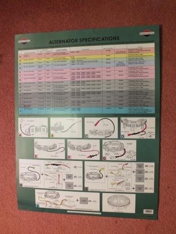

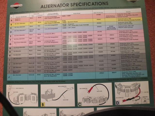

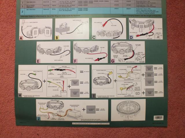

Wristpin 400 #11 Posted March 1, 2015 (edited) Not sure how these images will travel but they're the best I can do with the point and press! Yours is illustration G Edited March 1, 2015 by Wristpin Share this post Link to post Share on other sites
the showman 4,074 #12 Posted March 1, 2015 Thanks mate, it's a bit blurred when I enlarge on my iPad, I'll have a look on the laptop later, might be better Share this post Link to post Share on other sites
Wristpin 400 #13 Posted March 1, 2015 (edited) Right, going to try posting in original format rather than reduced for email/forum posing - may take some time at my rural upload speed!!! 2min 12 sec per image!! Edited March 1, 2015 by Wristpin Share this post Link to post Share on other sites
the showman 4,074 #14 Posted March 1, 2015 Fantastic mate, I can read that now, i'll print that off so its at hand when iam outside, thanks again Share this post Link to post Share on other sites
