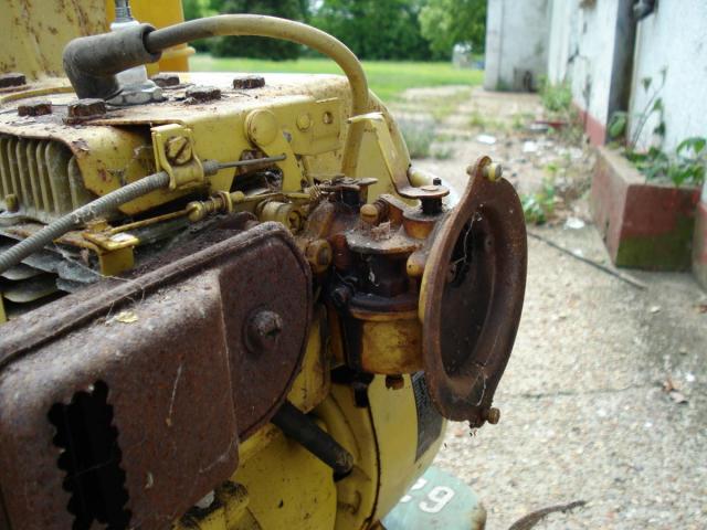

jparkes43 27 #1 Posted June 6, 2015 (edited) Hello.As some of you may know i am restoring my 1968 wheel horse lawn ranger and it has a 6hp tecky h60 in it.now no matter what i try it will not run, well it ill sort of start and maybe run for a few seconds but will never stay running. i have tried adjusting the carb and using different amount of throttle and choke etc but still no luck. yes i have fresh fuel. any help is greatly appreciated. And it has a brand new spark plug, also it makes no difference if you are running and air filter or not, also after trying for a while it starts to pop and spit slightly out the carb is this something i should be worried of? also as a long shot for you uk guys i don't mind if you are nearby want to come in a help out, or i don't mind going to your place if you aren't to far away to see if you can help maybe for a weekend like i don't mind traveling if you offer for help and i will bring it down. thanks​james Edited June 6, 2015 by jparkes43 Share this post Link to post Share on other sites

Anglo Traction 1,022 #6 Posted June 6, 2015 Well James, H60 Techies and their Series 1 Lauson Carbs can be a challenge. My only credentials with these was to revive one that was derelict for a good 25 years with a solid varnished up Carb, missing parts and no spark. Got it running, but only after a top end and Valve refurb and new points/Condenser. Have you been working on the engine at all, I.e. set the timing, stripped and cleaned the Carb?. My initial suspicion is the Carb. Have you referred to the Engine Manual for instructions on Carb servicing?. I would need your Engine Numbers to see what Carb you have and go from there if no one else local to you can help. Share this post Link to post Share on other sites
jparkes43 27 #7 Posted June 6, 2015 yes living up to the troublesome tecky name. i have done no work apart from fiddling with the carb and a new spark plug. that was my idea aswel. no i did look in my manual but cant find much. i will let you know on my numbers as soon as i can. also i have set my carb to the settings i found on the internet but it still doesn't solve it. ok well where you are isn't to far away so its a possibility thanks anyway james Share this post Link to post Share on other sites
Anglo Traction 1,022 #8 Posted June 6, 2015 Ok James, As you haven't been inside the Carb and it is a Series 1, then I suspect the Float and/or Valve is causing a flooding issue and the 'Blow Back' . Idle and run issues are caused by dirt and clogged passages which cause problems adjusting settings. Overhaul kits for these include Welch plugs which have to be removed/replaced to access some passageways. There is also a Metering Rod inside one of these which can get stuck with dirt. Kits are still available and again, if it is a Series 1, then I have a NOS Boxed Brass Carb Float you can have. In addition to the Engine numbers, if you can post a few pics of the Carb with the Filter removed, I may be able to confirm it easier. Here's one of the Engine/Carb I had to deal with (although the linkage will be different) to possibly help with I.D. - Share this post Link to post Share on other sites

jparkes43 27 #19 Posted June 7, 2015 Hello, so today i took the carb off and took some good pictures for you guys, any advice on cleaning like what do i do etc image is unclear but it reads 3589H2 i beleive 40 james Share this post Link to post Share on other sites
jparkes43 27 #20 Posted June 7, 2015 hello i did decide to take apart the carb and clean it a bit and heres where i am at. but i still need further helpjamessome people have said about blowing out the everything with an air compressor? Share this post Link to post Share on other sites
jparkes43 27 #21 Posted June 7, 2015 OK. i am literally done with this thing after a carb teardown, thorough clean and put back together and the settings all corrected i am still having no luck i am still at the same point as i was yesterday i tired a variation throttle/choke positions AND fuel mixtures. I am out of ideas. Please help james Share this post Link to post Share on other sites
