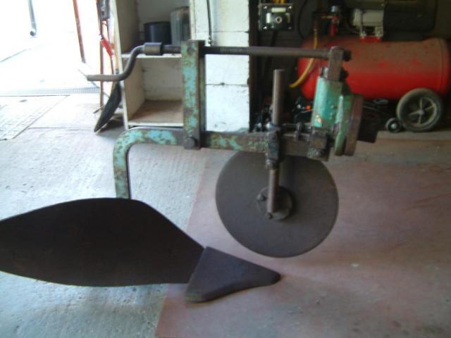

Stormin 4,458 #1 Posted June 11, 2015 I now have a plough, courtesy of Alan and the kindness of The Showman, who collected t and brought it to Newby Hall. So I thought I'd do a refurb thread o it. As it looked a couple of hours ago. It is now partly in pieces. More photo's tomorrow. Share this post Link to post Share on other sites
the showman 4,074 #2 Posted June 11, 2015 Hope my diesel soaking every day helped Norm Share this post Link to post Share on other sites

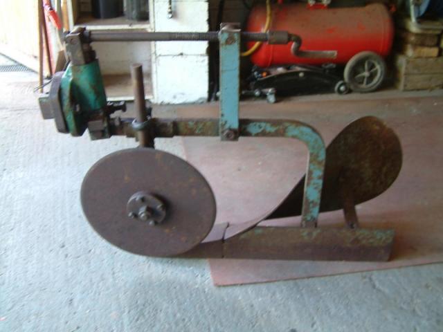

Stormin 4,458 #3 Posted June 11, 2015 The screw's still seized as is the disc. But the share's off. Share this post Link to post Share on other sites
Charlie Smith 192 #4 Posted June 11, 2015 Very nice, bet you're pleased now it's home, My disc too is seized apart from that I've freed most of mine up, ill be following this with interest! Share this post Link to post Share on other sites

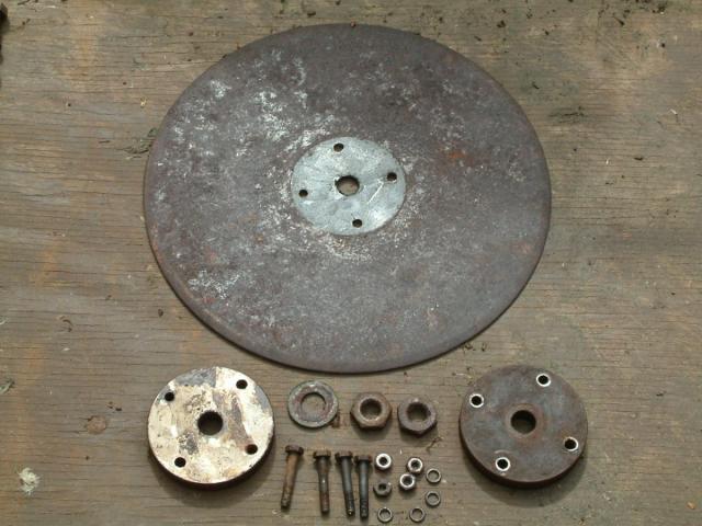

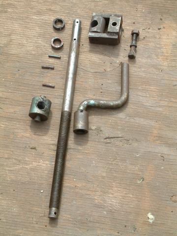

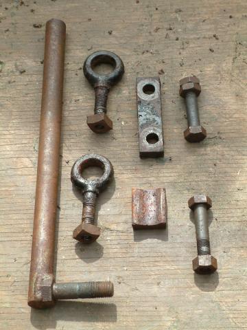

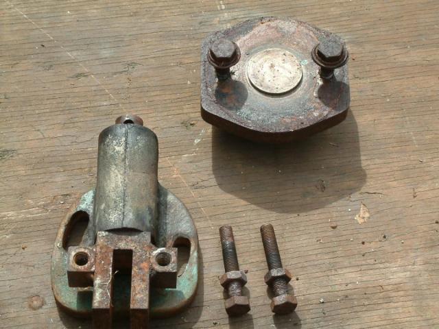

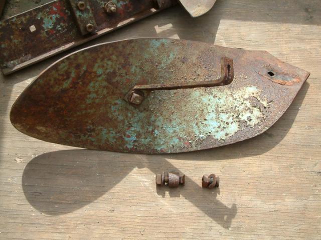

Stormin 4,458 #5 Posted June 12, 2015 The plough is now in it's component parts. I did find that the adjusting screw and nut were not seized as I thought. It was the opposite end to the handle. First I removed the disc. Now I'm not sure if this should go round. I would think so, but it seems to just revolve on a bolt. Then off came the share. That off, I removed the adjusting mechanism complete. I had to carefully prise open the brackets holding the nut. This was done with a little screw jack. The next parts came apart with little difficulty. Next came the difficult bits. The block and pivot on the adjusting screw proved to be somewhat stubborn. The screw would just not turn in the pivot. Heat was applied to no avail, Eventually with brute force, but not ignorance I got them apart. So the next job is to get things cleaned up and painted. That could be a bit off. 2 slf-uk and Alan reacted to this Share this post Link to post Share on other sites
nigel 1,880 #6 Posted June 12, 2015 dont paint the blade norm , i did and when i went to do some ploughing every one laughed cos it wont do the job properly the blade shoughed be polished according to propper ploughmen Share this post Link to post Share on other sites
Stormin 4,458 #7 Posted June 12, 2015 That bit about ploughing I do know, Nigel. Nowt else, just that bit. And I do work on a farm. 1 the showman reacted to this Share this post Link to post Share on other sites
