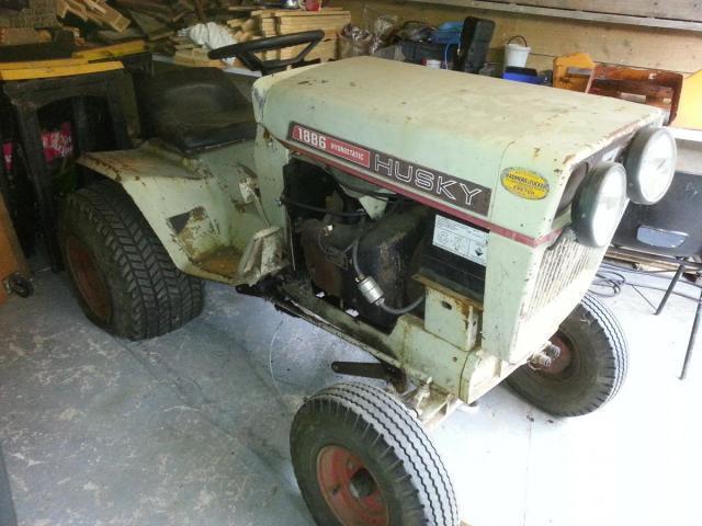

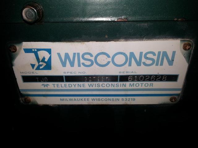

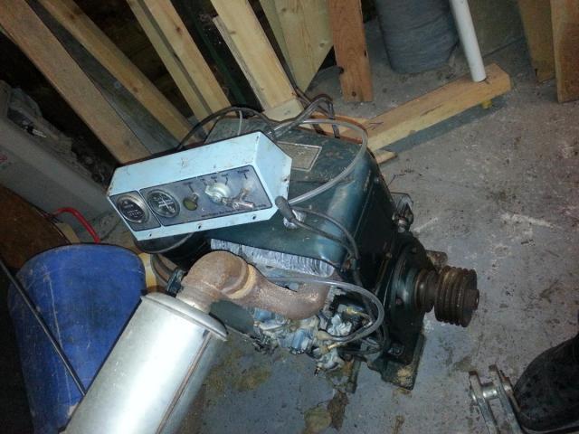

Hi i got a Bolens 1886 with a blown engine i think its thrown a conrod .I cant seem to find any spares at a reasonable price so im thinking of putting a Wisconsin TJD
in (i just happen to have a tidy TJD ) unless anyone knows of a kohler 482s going cheap
thanks nick

I bought it from Abbey mowers last year its got a nice big mowing deck with it.  A customer of theres sold it with his house the new owner ran it without oil
havent had chance to sort it yet id like to keep it original as its so  tidy but ive yet to find another kohler .

the 1886 doesnt run

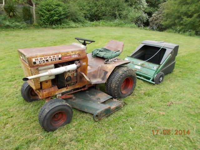

I got an 1886 which works :D . You will spoil it if you put that other engine in. I rebuilt my engine with new rings & valves & a coil. Is a beast of a mower & I love it
Bet if its been run low on oil then the crank will be shot. Its very hard to find certain parts for these twins any more unless you get 2nd hand from the US but most of them are shot as well
Chris
nice pic deck looks the same as mine
id like to sort the engine thats in and keep it original because it doesnt look to have been messed with  but second hand parts from the states are a fortune
the wisconsin ive got is in realy good condition and its a better engine.

Not as powerful as the Kohler.
Parts are not a fortune if you ask the right people. Shipping is the killer, but if you want it right you have to pay for it
You wont know what the engine is like until you pull it apart. They are very heavy lumps. not too bad to get out. Its the drive shaft you may have an issue with

BTW the TJD is an 18hp twin ive seen a few conversions in the states
