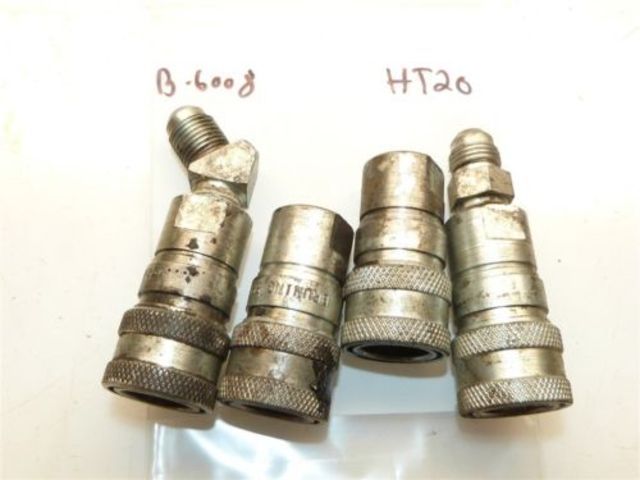

moogie 372 #1 Posted May 1, 2016 Would anyone know the size of the male hydraulic fitting that goes into these ? 1 Triumph66 reacted to this Share this post Link to post Share on other sites
Chris 642 #2 Posted May 1, 2016 I wish you luck if you finding any males to fit these There was some talk on another forum I go on & the answer was rare as unless you have the attachments with them fitted I also would like to find some as would be handy to make some hydraulic attachments May be take the females to hydraulic company & see what they have to say 3 Triumph66, diggerjames and minky reacted to this Share this post Link to post Share on other sites
Triumph66 1,256 #3 Posted May 2, 2016 That's my understanding too. The only other thing is to dig deep and try and get the parts from the US from a supplier who might be breaking a HT20/ implement. Share this post Link to post Share on other sites
moogie 372 #4 Posted May 2, 2016 2 hours ago, Triumph66 said: That's my understanding too. The only other thing is to dig deep and try and get the parts from the US from a supplier who might be breaking a HT20/ implement. Im heading for Florida on Tuesday so hope to get some while im there, if i can get a size. 1 Triumph66 reacted to this Share this post Link to post Share on other sites
Triumph66 1,256 #5 Posted May 2, 2016 Get in touch with Rick aka Blackjakexxxxvvx on GTT. He's a top bloke and may be able to help you out. You could mention my name Andrew from the UK. Enjoy Florida! 1 moogie reacted to this Share this post Link to post Share on other sites
meadowfield 1,901 #6 Posted May 2, 2016 Which end do you mean? one end is 1/2" JIC, the other looks like ISO A. If they are ISO they are easy to get hold of, but usually to BSP. If you need JIC then it's easier to get pipes made to adapt than it is to get JIC to BSP.... 1 moogie reacted to this Share this post Link to post Share on other sites
