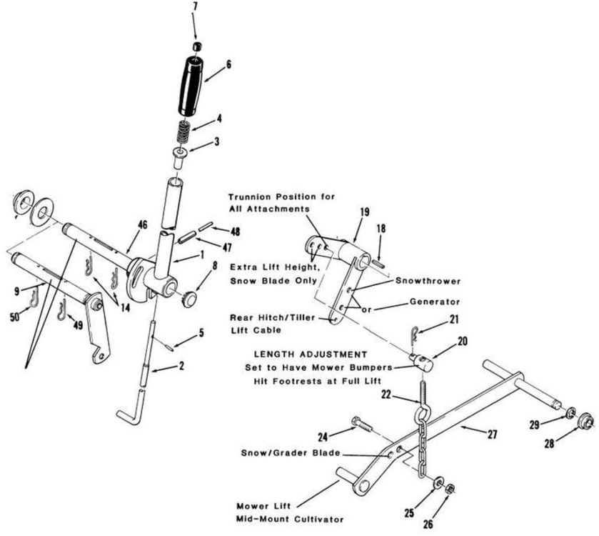

Rayp 48 #1 Posted June 16, 2016 Can anyone help with a diagram of the lift linkage, i.e. into which holes in the Lift Arm and Bell End the Lift Arm should fit and does anyone know a supplier for the bushes which fit into the chassis at the ends of moving spindles. I tried to upload some pictures, but the upload failed and I will have to try and find out why. Share this post Link to post Share on other sites

meadowfield 1,901 #4 Posted June 17, 2016 Does this help? 1 Rayp reacted to this Share this post Link to post Share on other sites
Anglo Traction 1,022 #5 Posted June 17, 2016 If one of the bushes you require is #28 in Mark's diagram above, I may be able to help. If I remember rightly, that Bronze Bushing is 1/2" bore x 9/16" x 3/4" flange (part nbr 6229). I need to make one myself . If you need others like PTO Lever Rod bushes or the Fender Seat pivot bushes on the earlier models (different sizes and part nbrs), I also have made these for my Tractors. I'll have to check my stock of Gunmetal Bronze, but sure I have enough to make a few more. Send me a PM of you need any more help. 1 Rayp reacted to this Share this post Link to post Share on other sites
