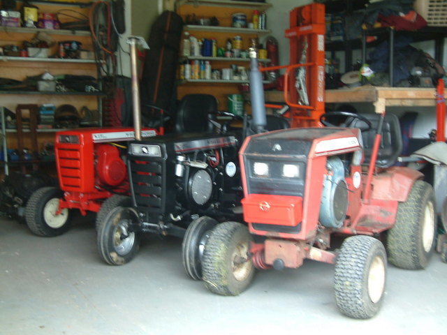

Stormin 4,458 #1 Posted August 4, 2016 The Work Horse, C-125, has been a bit off colour lately. Suspect dirt in the carb. So today off with the float bowl and my suspicion was correct. Some strange foreign particles floating about in there. Cleaned and re-fitted, then started up and did the hand over venturi trick to clear the jets. Re-set the carb for idle then full throttle and the old thing is running like a good un. I then decided to check over the C121 and C81 as they are going to R.P.T. and Biddenden shows. They are both now in the peak of fitness. Here they are, snug as bugs in a rug. 6 pmackellow, Ian, Triumph66 and 3 others reacted to this Share this post Link to post Share on other sites
