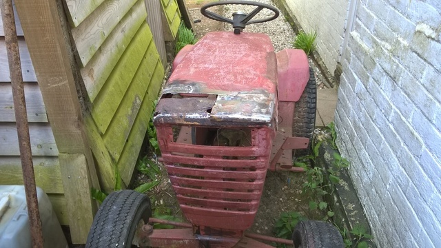

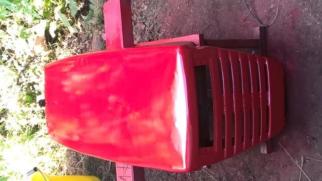

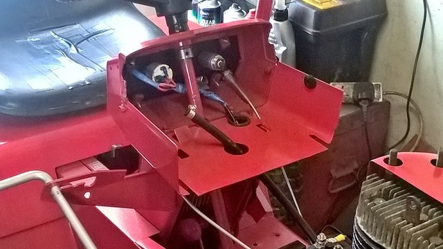

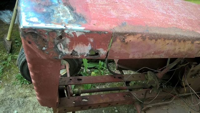

rex harrison 7 #1 Posted September 28, 2016 Hi Fellas, Here are some photos of my Raider 10 Build which now wears a 321 Engine. It is nearly finished i am currently just waiting for a fuel tank. Cheers, Rex321 4 wurzel, Stormin, the showman and 1 other reacted to this Share this post Link to post Share on other sites
the showman 4,074 #2 Posted September 28, 2016 Looking good Rex, made a good job of the bonnet. Share this post Link to post Share on other sites
Stormin 4,458 #3 Posted September 28, 2016 1 minute ago, the showman said: Looking good Rex, made a good job of the bonnet. I was just about to say that. Very nice job, Rex. Share this post Link to post Share on other sites

Anglo Traction 1,022 #5 Posted September 28, 2016 Hi Rex, Excellent work there with the repairs and progress. Now that we can see it, I'm going to stick my neck out here and say that the Tank Support Plate has had the end chopped off . It should extend past the side plates by 3-4 inches. I suspect it has been trimmed to accommodate an engine that had a Fuel Tank bolted to the engine sometime in the past. Also the elongated holes in the Frame are a giveaway. It needs either extending again and modifying before you can fit a Tank on it, or look for one from a 70-75 Model (will fit straight on and have the correctly located holes etc). Share this post Link to post Share on other sites
