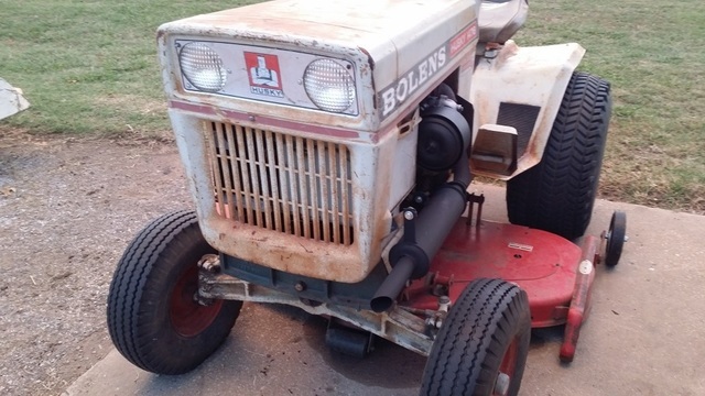

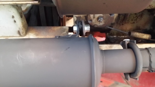

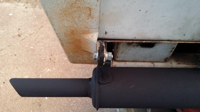

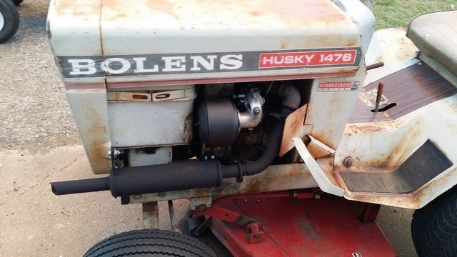

HeadExam 1,783 #1 Posted October 2, 2016 The first picture is what I started with. I bought a International Cub tractor muffler (IH-1, part # 351436R92) for 29.00 and fabricated my own mounts, I added a 1/4" hard rubber between washers to create a dampening effect to reduce vibration. I'll order a chrome slotted heat shield for it next week that will cover the body. 5 Anglo Traction, Triumph66, 4x4forks and 2 others reacted to this Share this post Link to post Share on other sites
Anglo Traction 1,017 #2 Posted October 2, 2016 Very tidy job on the Muffler. Of course you do realise that putting a new Chrome Shield on it will most likely force you to consider refurbishing the Whole Tractor ! 2 HeadExam and Stormin reacted to this Share this post Link to post Share on other sites
HeadExam 1,783 #3 Posted October 2, 2016 1 hour ago, Anglo Traction said: Very tidy job on the Muffler. Of course you do realise that putting a new Chrome Shield on it will most likely force you to consider refurbishing the Whole Tractor ! Whaaaaaaat! Oh No. Share this post Link to post Share on other sites
