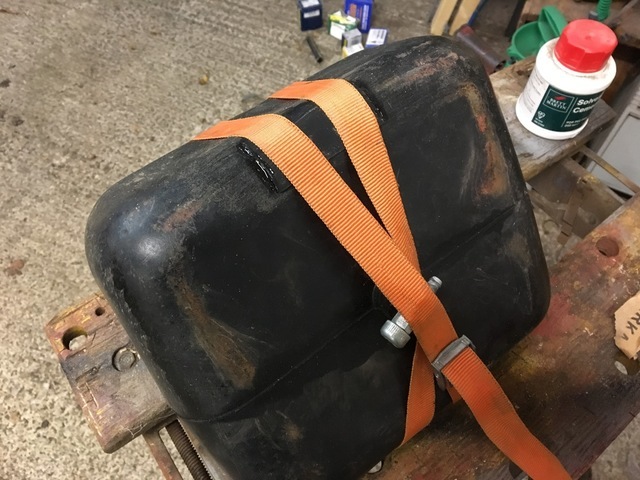

meadowfield 1,901 #10 Posted November 7, 2016 On 05/11/2016 at 7:59 PM, Anglo Traction said: Hope you find a spare Mark, just realised you had the Dash Tower mounted Black Tank on 'Bendy'.....just sold my spare one (reluctantly), so can't help. Worrying prospect if it becomes a trend. Ive glued a patch on.... see if that holds Share this post Link to post Share on other sites
Anglo Traction 1,018 #11 Posted November 7, 2016 Strange!. It look's like it split at the front where the spring retainer is located (no seam). Only leaks I know to have occurred on these is like what Chris (Showman) mentioned.....along the heat welded seams. Must have been a flaw, or wear?. Share this post Link to post Share on other sites
meadowfield 1,901 #12 Posted November 7, 2016 It's where the spring touches the crack was horizontal! I can only assume it's a combination of age, cold and the tension of the spring... I may use a rubber band to hold it down when the glue dries... Share this post Link to post Share on other sites
