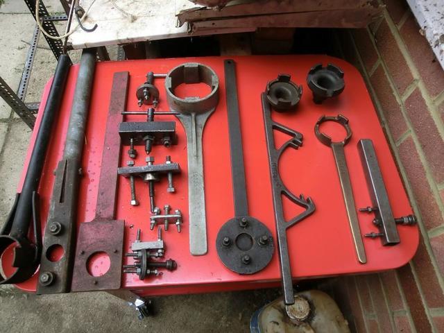

Wristpin 399 #7 Posted December 21, 2016 Presume that you are referring to the starter clutch. It is screwed to the crank, conventional right hand thread and should be undone using a special tool. However, with care it may be undone with a large stillson or a hammer and hard wood block against the lugs that the top screen screws to. Take care as those lugs were not designed to tak impacts - just a steady pressure. The "bronze" wrench, one in from the right, is the clutch removal tool and the "half moon" one beside it is the flywheel holder . The two cup shaped ones above them are clutch tools, early and late, for use with a torque wrench or breaker bar. Share this post Link to post Share on other sites
Potash123 26 #8 Posted December 22, 2016 Easy I thought. All the sprints I have worked on have a nut holding on the flywheel. This one must be older as the starter mechanism is fitted over the flywheel. I have pullers but cannot see how it comes off so I can change the key. Thanks lads. Many thanks, what a superb set of tools, a bit like my Norton BSA kit. Share this post Link to post Share on other sites
