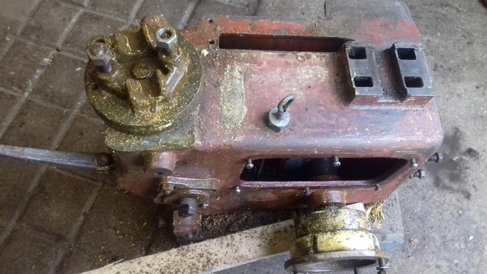

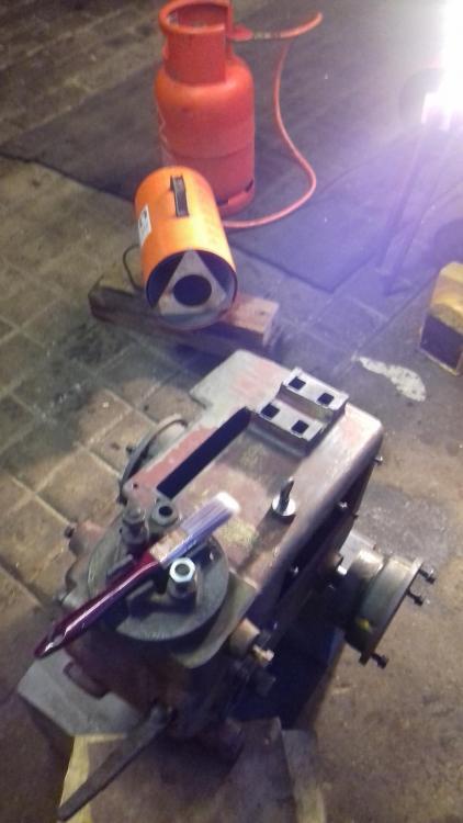

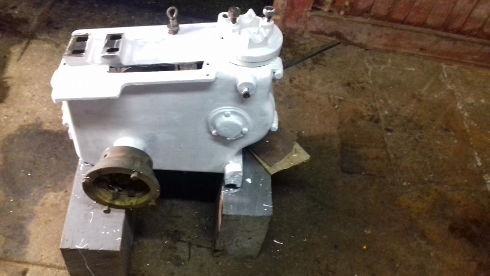

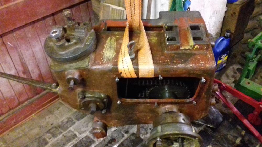

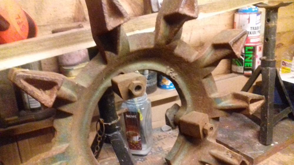

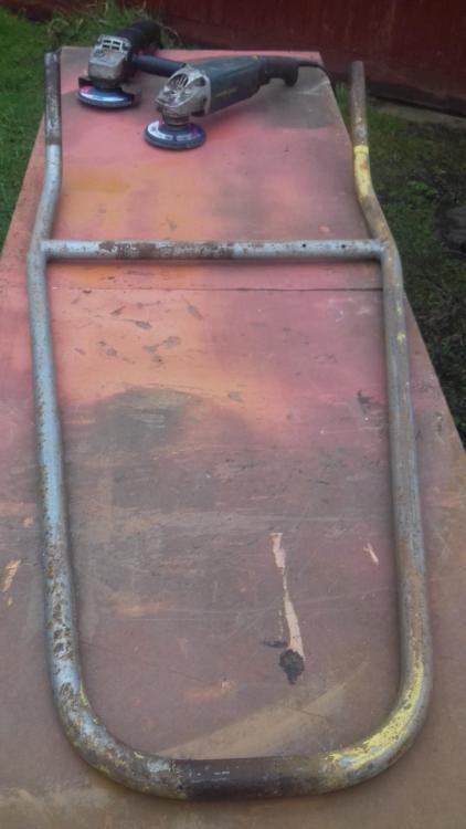

callander ploo-man 88 #1 Posted January 14, 2017 (edited) Here is todays progress on the auto culto I have stripped the yellow paint of the albion gear box just to check oil level. Also started to remove paint from villers engine. also started removing paint from tractor gear box. Started to strip down the strakes. Edited January 14, 2017 by callander ploo-man 2 S1g and Stormin reacted to this Share this post Link to post Share on other sites

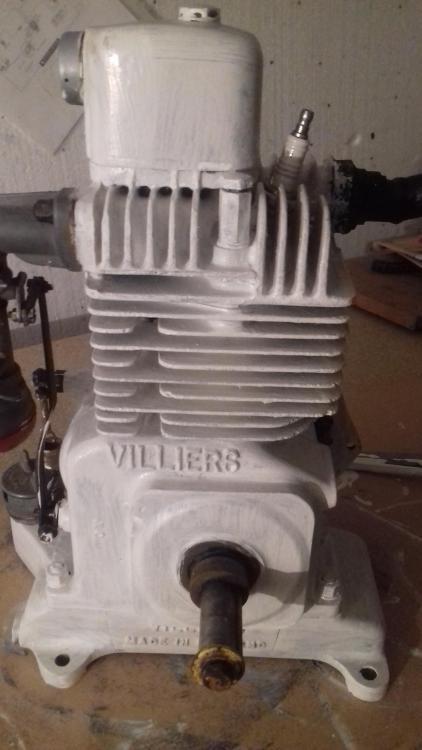

callander ploo-man 88 #6 Posted January 16, 2017 Good evening to all After along discussion I have decide to christen my new project The Border Reiver. Just finished putting on the first undercoat on Villiers engine just heading back out to shed for some more sanding down tank straps Share this post Link to post Share on other sites

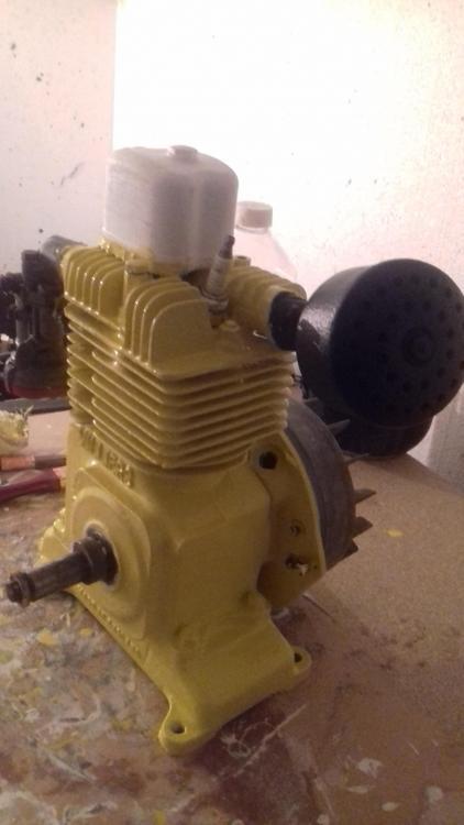

callander ploo-man 88 #9 Posted January 19, 2017 Here is the Villiers engine with first coat of paint. 2 S1g and Stormin reacted to this Share this post Link to post Share on other sites

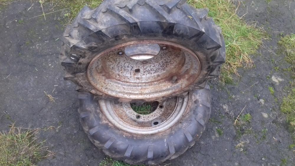

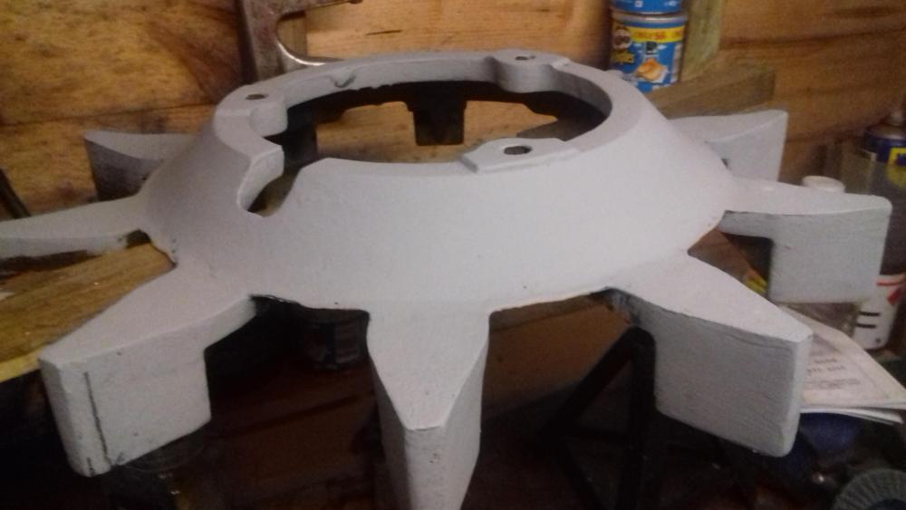

callander ploo-man 88 #11 Posted January 22, 2017 (edited) Well i had a very busy sunday and looks like I have plenty of work to get on with All that horrible yellow paints gone Now going to tackle wheels and remove that horrible silver with nice new blue paint. Also had help to get the plough ready all bolts have had a run with the taps to clean threads make bigs difference. Edited January 22, 2017 by callander ploo-man 1 Stormin reacted to this Share this post Link to post Share on other sites
callander ploo-man 88 #12 Posted January 27, 2017 (edited) Hello Here is the result after spending 3hr this afternoon. First coat of paint on auto culto wheels. Edited January 27, 2017 by callander ploo-man 2 Stormin and S1g reacted to this Share this post Link to post Share on other sites

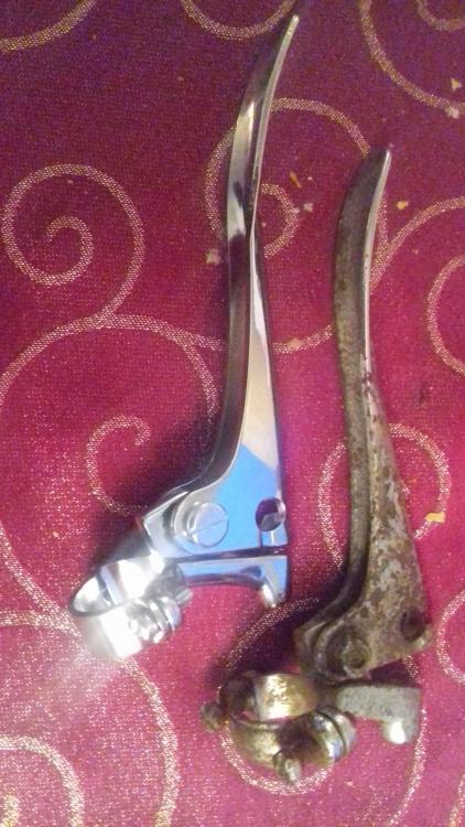

callander ploo-man 88 #17 Posted February 1, 2017 Well that more painting done the night New levers arrived to day 1 Stormin reacted to this Share this post Link to post Share on other sites

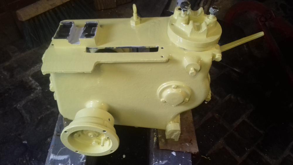

callander ploo-man 88 #20 Posted February 3, 2017 First thing to do get rid of any oil muck grease with stiff brush or scraper lash on plenty paraffin also protect your coils from getting damp when cleaning. Also let the paraffin soak into the muck grease for about twenty minutes. I sat my engine in deep roasting tin to clean parts Don't buy Nitro mors does not work buy a good quality paint stripper then lash it on with paint brush wait till paint blister then a sharp scraper keep lashing on the paint stripper keep scrapping till its clean like the photo of gear box. Then wash down with paraffin then clean down with petrol, because the paraffin leaves traces of oil Then let the petrol dry of outside. I used 1/2" paint brush with long bristle to get undercoat between the fins on the cylinder head. Photo of engine 1st under coat. after cleaning. Hope that helps you 1 Rayp reacted to this Share this post Link to post Share on other sites

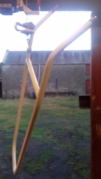

callander ploo-man 88 #24 Posted February 4, 2017 Busy day with The Border Reiver next step is rebuilding it Well thats all the horrible silver paint gone Handle bars prepared for under coat. The gear box had it first coat of the new yellow today Share this post Link to post Share on other sites

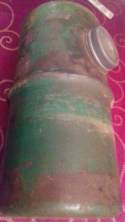

callander ploo-man 88 #25 Posted February 4, 2017 (edited) Next part and the last part to get make over is petrol tank Edited February 4, 2017 by callander ploo-man Share this post Link to post Share on other sites
