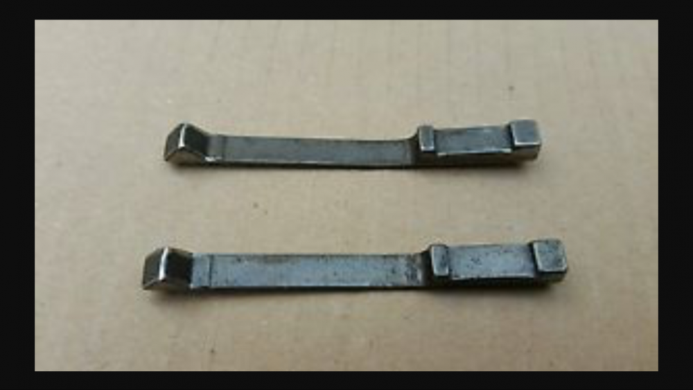

harryt 281 #12 Posted January 26, 2017 It will be something like this, however there are different sizes and you won't know until you open it up. Harry Share this post Link to post Share on other sites
Jack rush 0 #13 Posted January 26, 2017 Whats its called? Share this post Link to post Share on other sites
meadowfield 1,901 #14 Posted January 26, 2017 they are called gearbox selector keys, you need to cross reference from the parts diagram. They all look the same, but I don't know if they are. You need to open it up though first to check it is those that have failed Share this post Link to post Share on other sites
Jack rush 0 #15 Posted January 26, 2017 How can tell if they are broke Share this post Link to post Share on other sites
meadowfield 1,901 #16 Posted January 26, 2017 They will look like the picture if they are ok. If they are rounded over or snapped it will hopefully be obvious Share this post Link to post Share on other sites

Wristpin 400 #20 Posted January 27, 2017 (edited) The Peerless Transaxle illustrated is an early one with only two selector keys, later ones have four. The keys do not have to be broken to cause the lurching and jumping out of gear, just worn. It is the small triangular bit that does the work and engages into the free running gears to lock them to the shaft. If those triangles have rounded edges they will not make positive engagement BUT the matching faces of the gears do wear as well , so you need to inspect them as well. General wear and tear is accelerated by " impatient gear changing" - trying to shift on the move . Don't even think about trying to make new selector keys from "key steel" - waste of time! The box would originally have been filled with Bentonite grease which is still available but tends to dry out and be pushed to the outside walls of the casing where it ceases to lubricate where needed. Heavy semi-fluid grease is a better bet but if you are unable to obtain a small quantity , take a couple of handfuls of medium grease and stir in some SAE 90 or 120 oil and ladle that in. The box may leak a smidge but the internals will be lubricated! This may be useful. https://www.dropbox.com/s/69xl46g2qesbctv/Peerless 800 series transaxle0001.pdf?dl=0 Edited January 27, 2017 by Wristpin Dropbox images added. Share this post Link to post Share on other sites

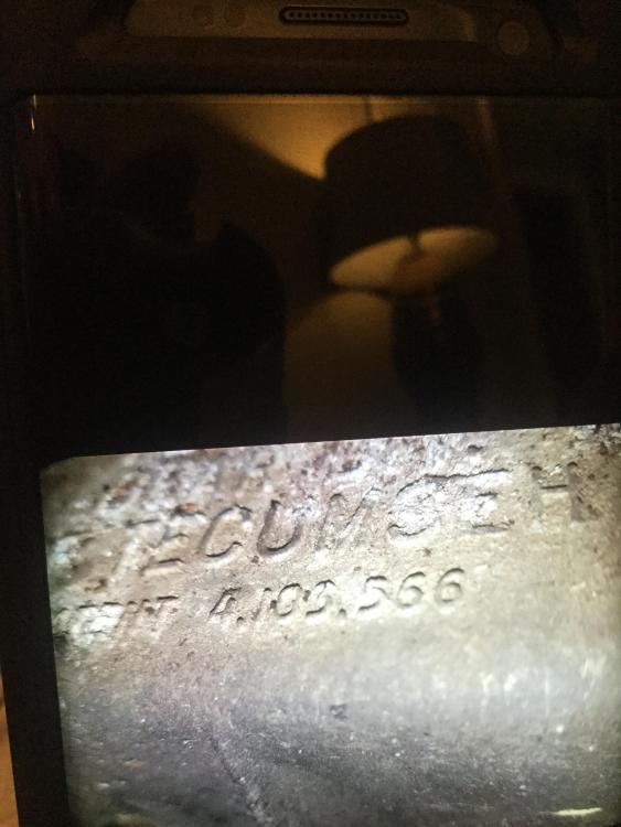

Jack rush 0 #23 Posted January 28, 2017 My peerless transaxle model number is 4.103.566 but I can't find shift keys for it if anyone can help me. Share this post Link to post Share on other sites
Wristpin 400 #24 Posted January 28, 2017 2 hours ago, Jack rush said: My peerless transaxle model number is 4.103.566 but I can't find shift keys for it if anyone can help me. That number is the patent number, not the model . You have an 800 series box, second one down in this Dropbox file. https://www.dropbox.com/s/cdfen8aaxl75m8m/Peerless MST selector keys.0001.pdf?dl=0 Share this post Link to post Share on other sites
