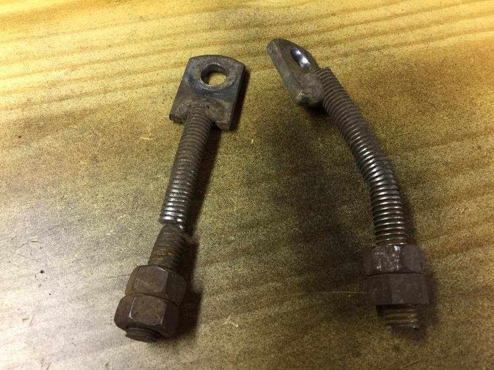

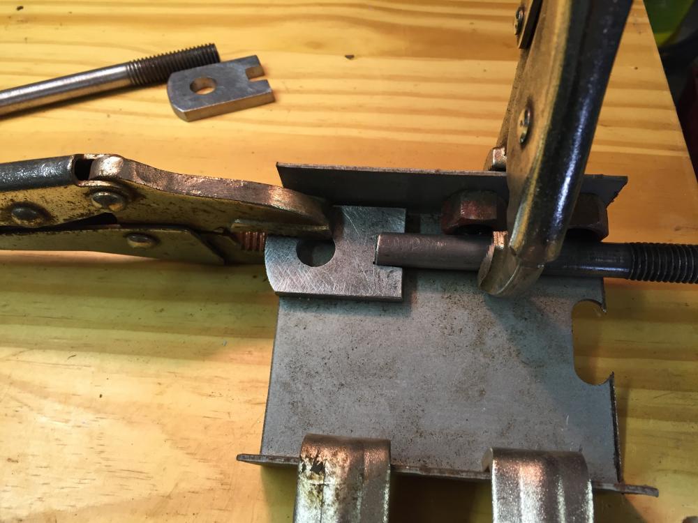

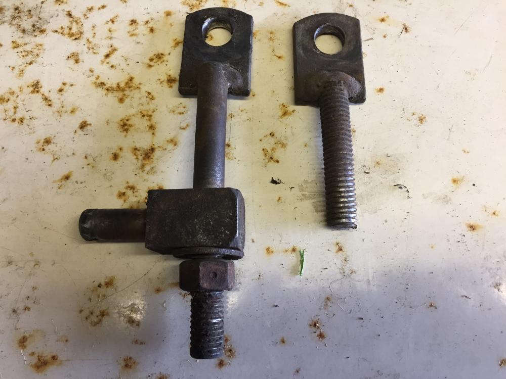

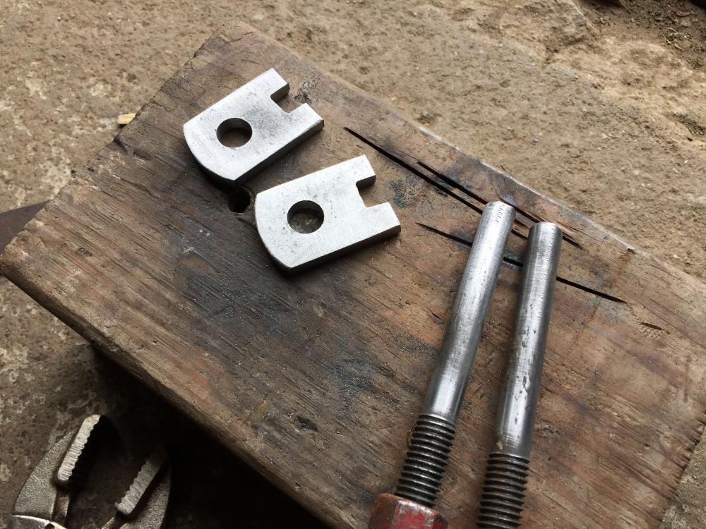

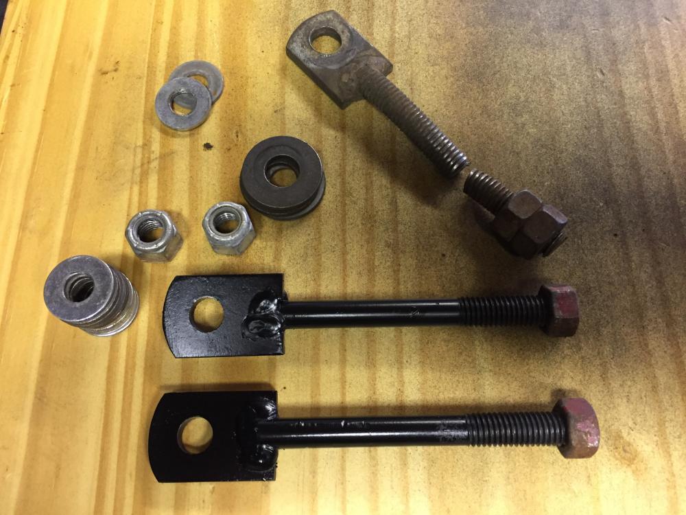

slf-uk 914 #1 Posted April 15, 2017 I am not sure if I have introduced my HT23 on here before. I bought the tractor in 2009 and I mainly use it for grass cutting duties Last year I lifted the deck and one of the deck lift bolts broke, I then managed to rip up the wood threshold on the door of my workshop trying to drive it in with the deck dragging on the ground. I have been a bit busy so it has taken me until now to get around to fixing it. First I remove the old lift bolts, looks like someone has been here before as they should not be made out of M12 threaded rod I then pulled one off my HT20 so I could see what they should look like I then made some replacement parts then I made a quick frame to hold the parts in place for welding I even gave them a quick coat of paint before fitting I can't believe what a difference it makes, the deck lift has never been this good. Another job done. Iain 9 harryt, Alan, Triumph66 and 6 others reacted to this Share this post Link to post Share on other sites
