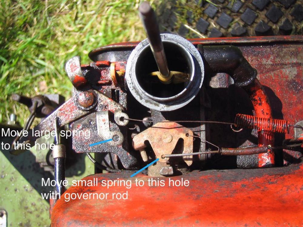

Rayp 48 #1 Posted May 11, 2017 Regrettably, I neglected to make a sketch or photograph the throttle and governor linkages on the top of the carburettor before removing it for an overhaul. I am now uncertain which holes to use for the throttle and governor springs and likewise for the 'wire rod' with cranked ends. The Parts Manual and/or Repair Manual are not helpful in showing where they attach. Can anyone please help? Share this post Link to post Share on other sites

Wristpin 400 #3 Posted May 11, 2017 The same question has just been asked elsewhere and having failed to find a decent digram in any BS book a friend has marked up an image. 1 Stormin reacted to this Share this post Link to post Share on other sites
Rayp 48 #4 Posted May 11, 2017 Thankyou for your offer Potash and many thanks Potash for the photo which is very helpful. Share this post Link to post Share on other sites

Rayp 48 #7 Posted May 13, 2017 Thanks Colin. I'll try and adopt your practice in the future as its not the first time I've relied on a manual only to find it is not very helpful. I've located the springs and wire as per the above photo but still need to fiddle as the smaller spring doesn't seem to be doing anything. Regards Ray Share this post Link to post Share on other sites
Wristpin 400 #8 Posted May 15, 2017 The small spring shares its anchor points with the rod and has an anti-rattle / hunting function. Its absence will probably go unnoticed on an old 21. It just keeps the linkage in tension. Share this post Link to post Share on other sites
