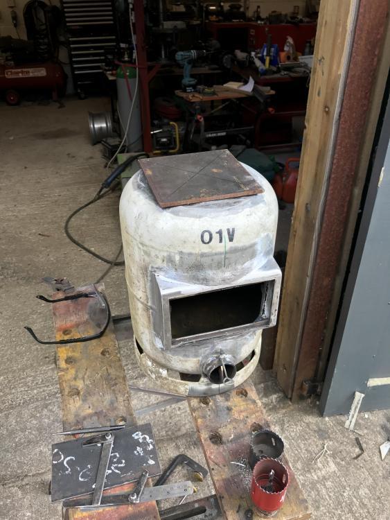

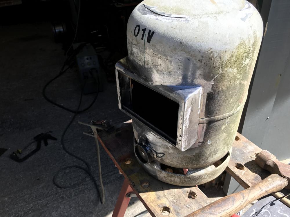

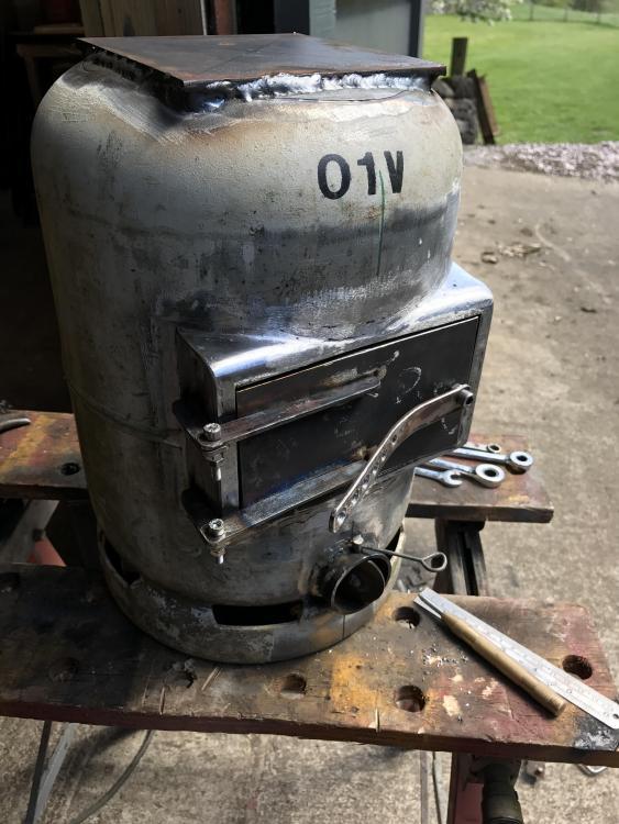

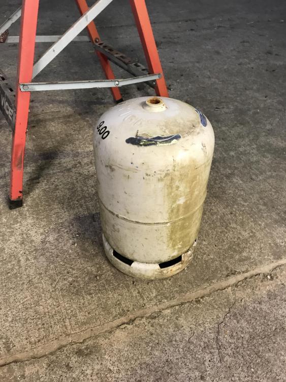

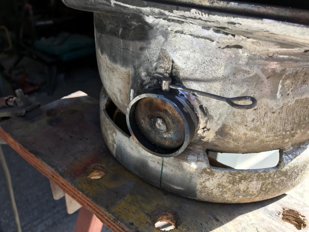

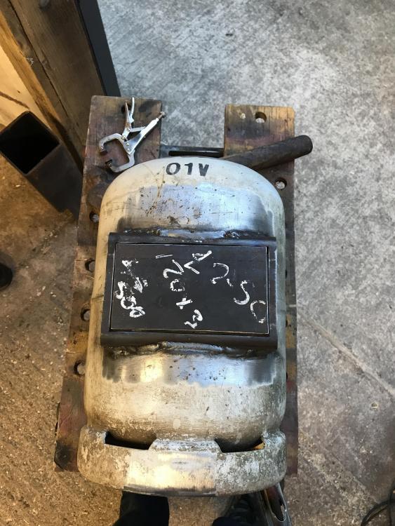

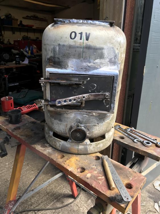

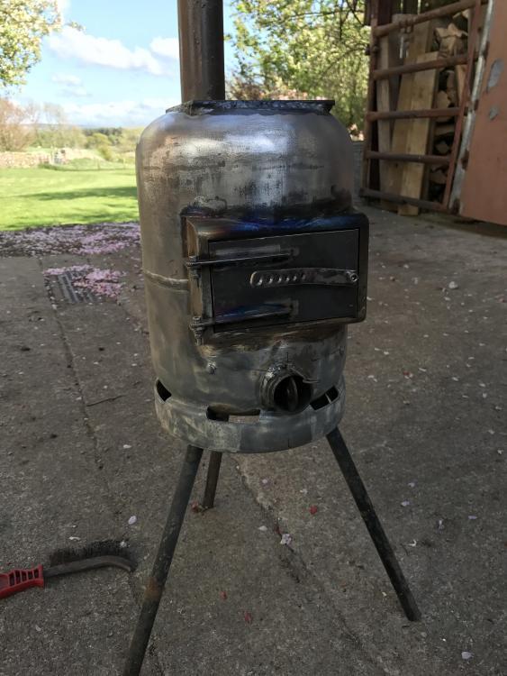

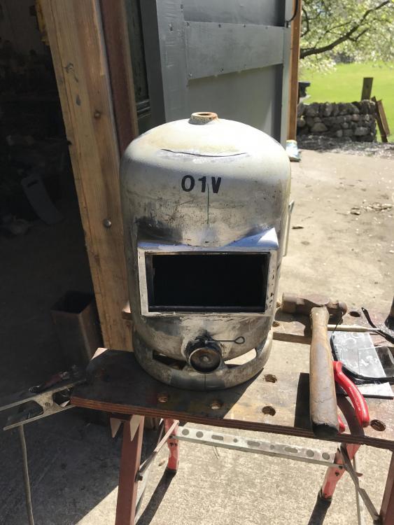

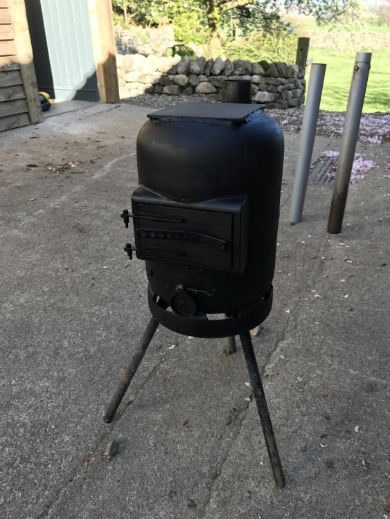

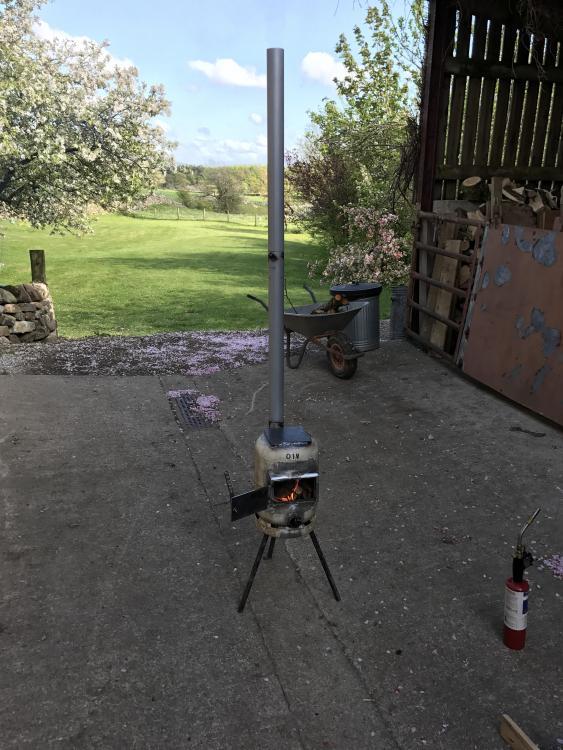

Cub Cadet 613 #1 Posted May 19, 2017 Ive had this small gas bottle hanging around for over a year, i've already made a forge out of a larger one but I have always wanted to make a little stove to cook on when we go to shows. with the help of my dads welding we knocked this up in a couple of days. The legs can be removed by loosening the bolts, the idea was to make everything quite compact. Im pleased with how its turned out, when I get round to it I need to add another air vent, a new handle and some other little bits but hopefully it will serve us well! 3 meadowfield, nigel and C-101plowerpower reacted to this Share this post Link to post Share on other sites

Cub Cadet 613 #3 Posted May 19, 2017 13 minutes ago, Stormin said: Nice work again, Ewan. I was going to take mine to Newby, but I don't think I'll bother now. Be to embarrassing. Cheers Norm, I don't know how it'll perform on wood consumption, its only small but it certainly got hot on the test run! Bring it along Share this post Link to post Share on other sites
Stormin 4,458 #4 Posted May 19, 2017 It'll get hot alright, Ewan. 1 Cub Cadet reacted to this Share this post Link to post Share on other sites
