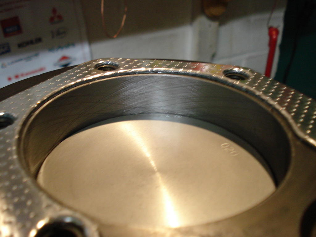

Anglo Traction 1,017 #10 Posted August 2, 2017 Depends on the condition of your engine Bore. If it is only lightly worn and been honed/de-glazed, then look to use Cast Iron .....they will bed in quicker. They should also be available in STD +0-003" oversize to fit in slightly worn Bore. They will also bed in better if the bore is slightly 'out-of-round'. Chrome rings , like Norm says will last longer, but the bore must be good i.e. straight, parallel and Honed. They won't tolerate dirty Oil. They are suited for high compression and performance conditions and take a long time to bed in, which means it will probably use more oil. Share this post Link to post Share on other sites

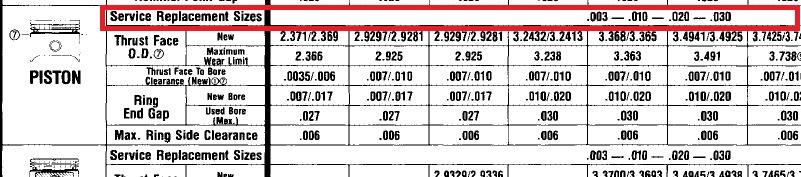

Wristpin 400 #11 Posted August 2, 2017 (edited) If you have a means of measuring the bore it will determine the best course of action. Without measurements it is a bit hit and miss. I think that Anglo T may have the decimal point misplaced as I read his post as being +3 thou. Iron rings usually come in +10,20 and 30. If the wear is within limits and a "service ring set" is available I would go for that as they usually include multi piece rings with expanders etc to accommodate wear. This extract from the Kohler manual may be of assistance. https://www.dropbox.com/s/2fmi9539dp0f0xq/Kohler Piston rings etc0001.pdf?dl=0 https://www.dropbox.com/s/2djv5e4hi2ppx6k/Kohler Specifications and wear tolerances0001.pdf?dl=0 Edited August 2, 2017 by Wristpin Spec sheet added Share this post Link to post Share on other sites
Anglo Traction 1,017 #12 Posted August 2, 2017 1 hour ago, Wristpin said: If you have a means of measuring the bore it will determine the best course of action. Without measurements it is a bit hit and miss. I think that Anglo T may have the decimal point misplaced as I read his post as being +3 thou. Iron rings usually come in +10,20 and 30. If the wear is within limits and a "service ring set" is available I would go for that as they usually include multi piece rings with expanders etc to accommodate wear. Yes, most likely get away with a Standard Service Ring Set if Ray is lucky.. No decimal point in wrong place Angus. If Ray's Bore is worn past the Std tolerance Limits, there is a small chance Paul at Meetens may just have a Piston/Ring set of +3 thou in stock (if anyone has them he will). This will allow just a de glaze/Hone and avoids a Rebore/Hone and requiring as you say +10,20 or 30 thou oversize- . I used Chromed edge Rings on my 12hp as it was rebored +20thou and honed to the correct angle of score marks for that type of ring to perform properly- Regards Share this post Link to post Share on other sites
Wristpin 400 #13 Posted August 2, 2017 +3 rings. - I stand corrected but have never seen them mentioned elsewhere until today! However there is a thread on the Red Square forum with a suggestion that they were a factory fit on production engines that were right at the limit of the measurement for a standard bore. All seems a little strange. Share this post Link to post Share on other sites
