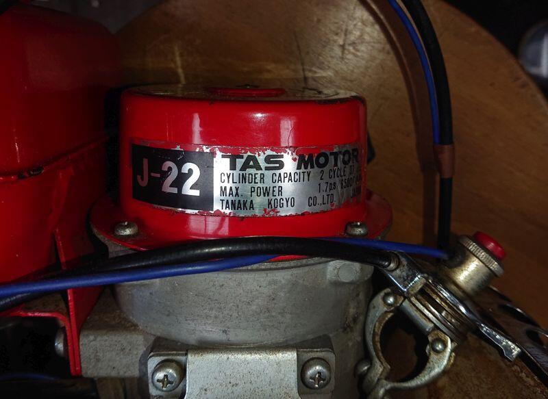

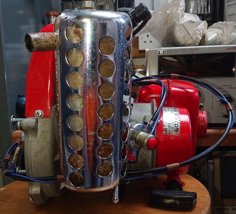

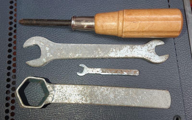

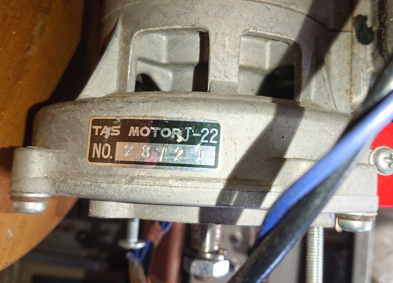

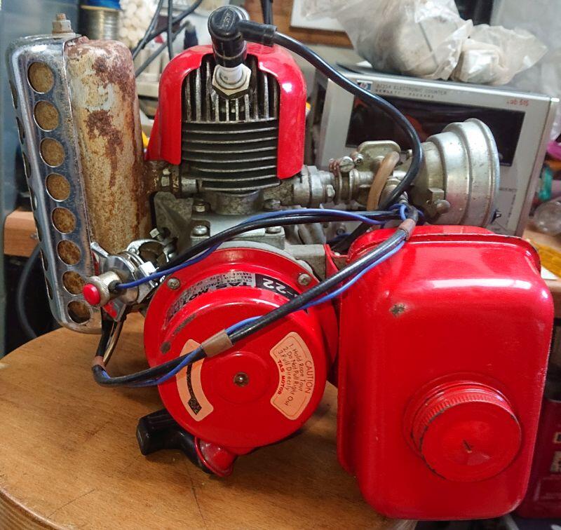

factory 487 #26 Posted August 13, 2020 Here are some pictures of the only TAS Motor I have in my collection so far, it's a type J-22 engine, I keep looking for one of the older TAS engines to go with it but haven't had any luck yet. It also came with what maybe the original toolkit. David 1 CNew reacted to this Share this post Link to post Share on other sites
CNew 408 #27 Posted August 13, 2020 David, That J-22 is super nice, wow! It looks like based on the orientation that it may have been set up for use on an outboard. I’ve seen several pictures, mainly from Australia, with some cool outboards using this style engine. There is a video on YouTube of one as well. I’ve also noticed that several of the screws don’t seem to be common metric threads. I’m missing some on mine and haven’t been able to find replacements, definitely not standard M4, M5 or M6 anyway... Share this post Link to post Share on other sites
factory 487 #28 Posted August 15, 2020 Yes I have seen similar engines on outboards, can you indicate which screws are missing and I could have a look at mine & see if I can work out the sizes. David Share this post Link to post Share on other sites

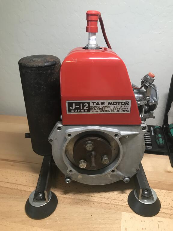

CNew 408 #29 Posted August 15, 2020 10 minutes ago, factory said: Yes I have seen similar engines on outboards, can you indicate which screws are missing and I could have a look at mine & see if I can work out the sizes. David I’m missing one of the small screws on top that holds the cooling baffle/cover to the head and then I’m missing two of the main screws that hold the crankcase cover together (see just below each corner of the red cover with the J-12 decal). Share this post Link to post Share on other sites
factory 487 #30 Posted August 15, 2020 OK will check them when I get a chance and let you know if I can find a match. David Share this post Link to post Share on other sites
CNew 408 #31 Posted August 15, 2020 Excellent, thank you. I need to get myself a thread gauge one of these days... they have to be metric (JIS), just not sure why the standard ones at the hardware store don’t work Share this post Link to post Share on other sites
H Killackey 6 #32 Posted August 16, 2020 On my old TAS P-7 I had to re-tap the threads to a modern/today standard metric thread pitch. The JIS metric thread pitch of 60+ years ago are similar but not the same as today. Get the M diameter size and a new tap and chase/reform the old threaded holes if you are going to us new M fasteners Share this post Link to post Share on other sites
CNew 408 #33 Posted August 16, 2020 Interesting, good to know. That would explain things... thanks for the recommendation! I found a seller on eBay that looks to have a few pre-1967 JIS screws, might be worth a try if I can narrow down the size. Share this post Link to post Share on other sites
factory 487 #34 Posted August 17, 2020 I wouldn't recommend rethreading them the standard ISO size unless you fit helicoils. The crankcase screws on my TAS J-22 are standard M6 x 1mm pitch. But the cylinder cooling baffle/cover screws are coarser than standard M5, a bit of checking & research find they are actually 0.9mm pitch, according to a 1941 book the French also used this size (the international standard didn't go below M6 then). The later Japanese stuff I have here including the FMC engines, car radios and test equipment have decals/stickers or markings to indicate they only use ISO threads. Hope this helps. David Share this post Link to post Share on other sites
factory 487 #35 Posted August 17, 2020 A bit more searching finds a Honda service bulletin with the pre-ISO JIS thread sizes for 3mm (0.6mm pitch), 4mm (0.75mm pitch), 5mm (0.9mm pitch) & 12mm (1.5mm pitch) threads. And a warning about stripping threads out if using the incorrect pitch. https://4-stroke.net/data-archive/honda-s-technical-service-bulletins/no-27-june-1967-change-of-threaded-parts.html Make sure any supplier/seller you find has the correct pitch before ordering. David Share this post Link to post Share on other sites
CNew 408 #36 Posted August 17, 2020 Thanks for all the research David, this is very helpful! I’ll have to take another look at the M6 threads. Mine shouldn’t be any different than yours. At least now with the correct pitch sizes I can start hunting for the correct screws. Share this post Link to post Share on other sites

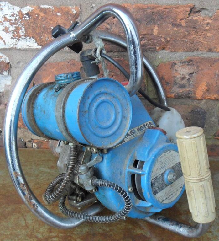

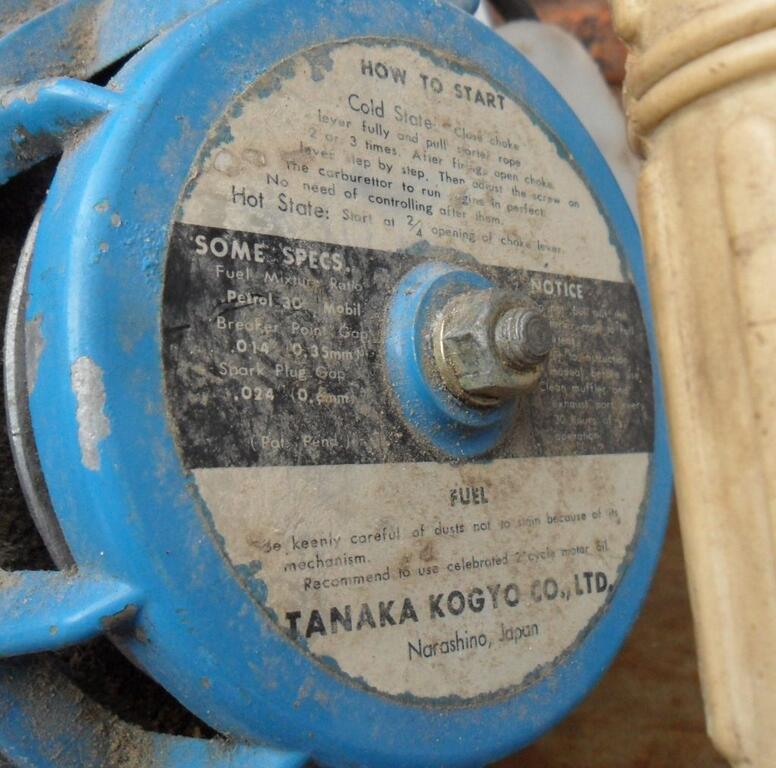

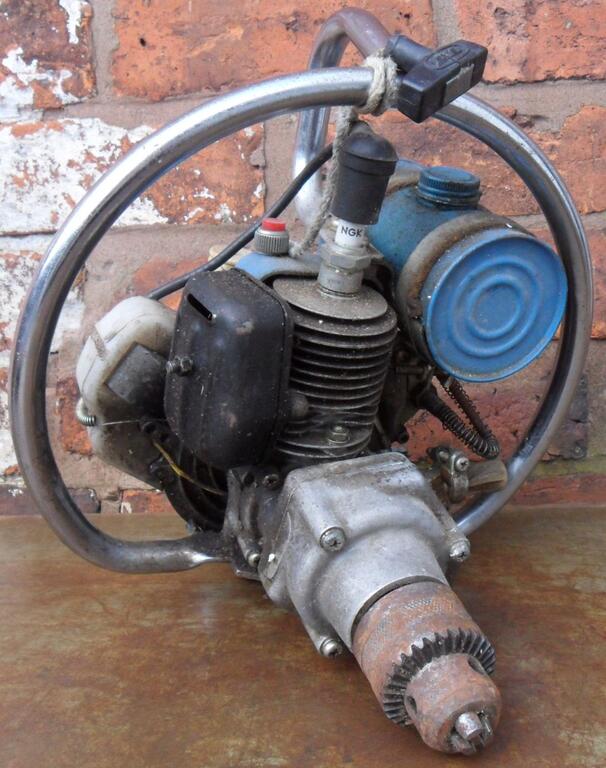

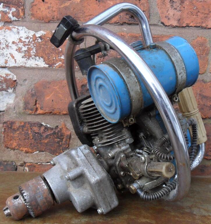

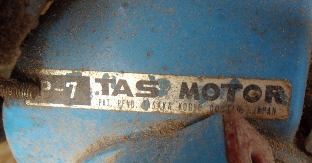

factory 487 #46 Posted January 9, 2021 A new addition to my collection is this TAS drill which was a Christmas present, the engine is a TAS motor P7 but the starter looks a little different from the other two drills on here, possibly a later version? David 1 pmackellow reacted to this Share this post Link to post Share on other sites
CNew 408 #47 Posted January 9, 2021 That is super cool, very nice Christmas present. Looks like it will clean very nicely! That starter looks a lot like the starter on my TAS P7 ice auger. Share this post Link to post Share on other sites

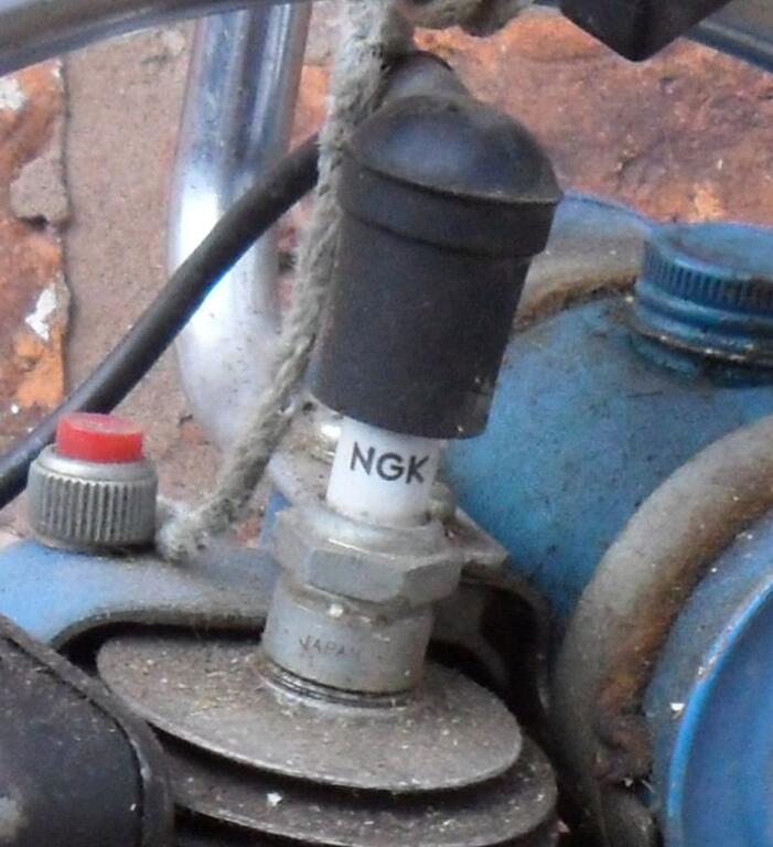

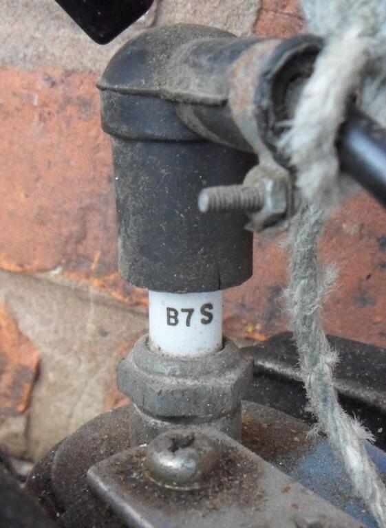

factory 487 #48 Posted January 9, 2021 It should clean up well, far too cold this time of year to do any cleaning though. Do you have any pictures of your TAS P7 ice auger? I couldn't see any when I had a look through the thread before posting, you were asking about the type of spark-plug for it, this TAS P7 drill has an NGK B7S if that helps. David Share this post Link to post Share on other sites

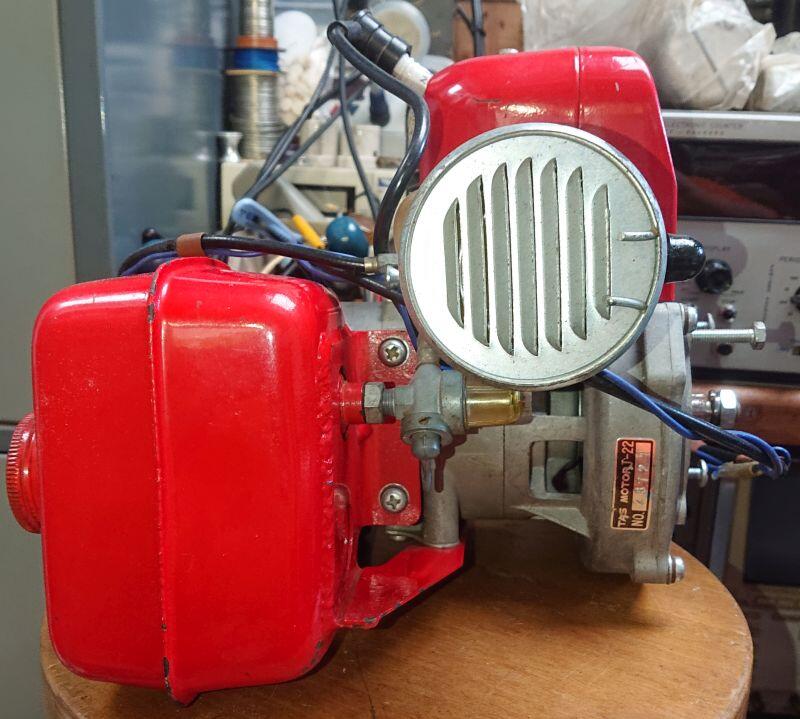

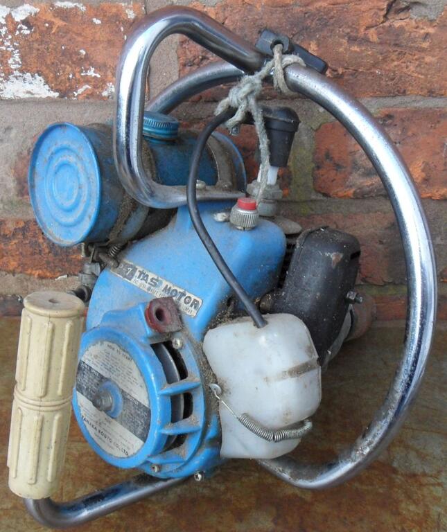

CNew 408 #49 Posted January 9, 2021 Here are some photos of the TAS P7 ice auger, it cleaned up pretty well. I had to replace the kill switch and make a new carb diaphragm and gasket, replaced the fuel and vent lines and the spark plug and it fired right up. 2 factory and pmackellow reacted to this Share this post Link to post Share on other sites
