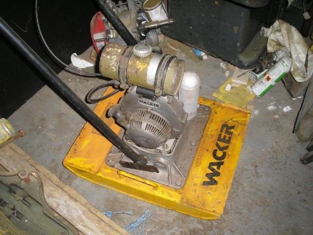

S1g 579 #21 Posted February 7, 2014 Here's some of my vintage wacker equipment that uses the same engine, just badged wacker instead of jalo. 1 vegikev reacted to this Share this post Link to post Share on other sites
