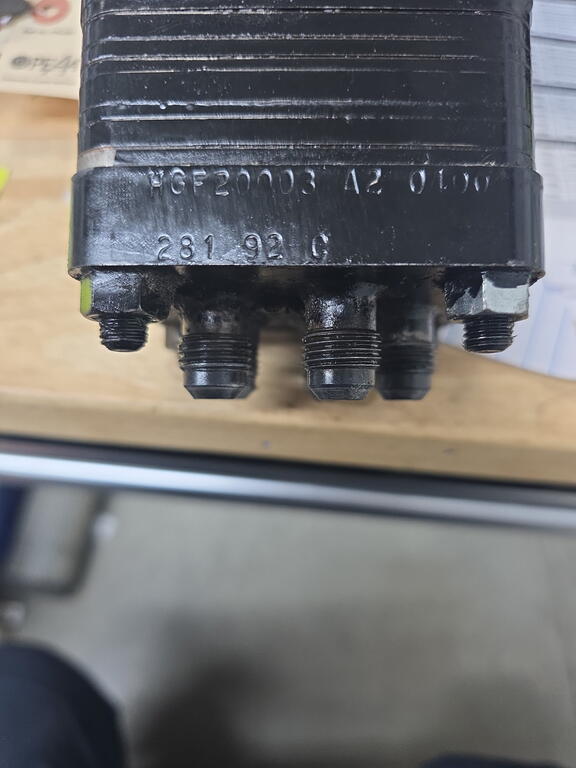

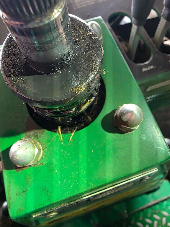

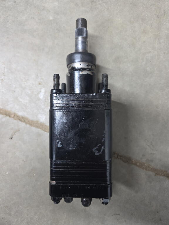

Topseller1975 0 #15 Posted May 18, 2025 I am in need of a steering box/pump for my 420 any ideas on a rebuilt kit or where to find one that is ready to go? 8102891148047534812.mp4 Share this post Link to post Share on other sites
