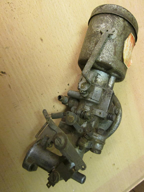

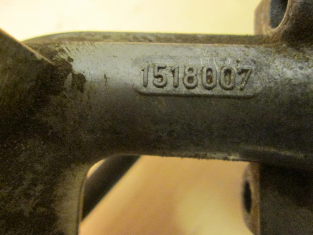

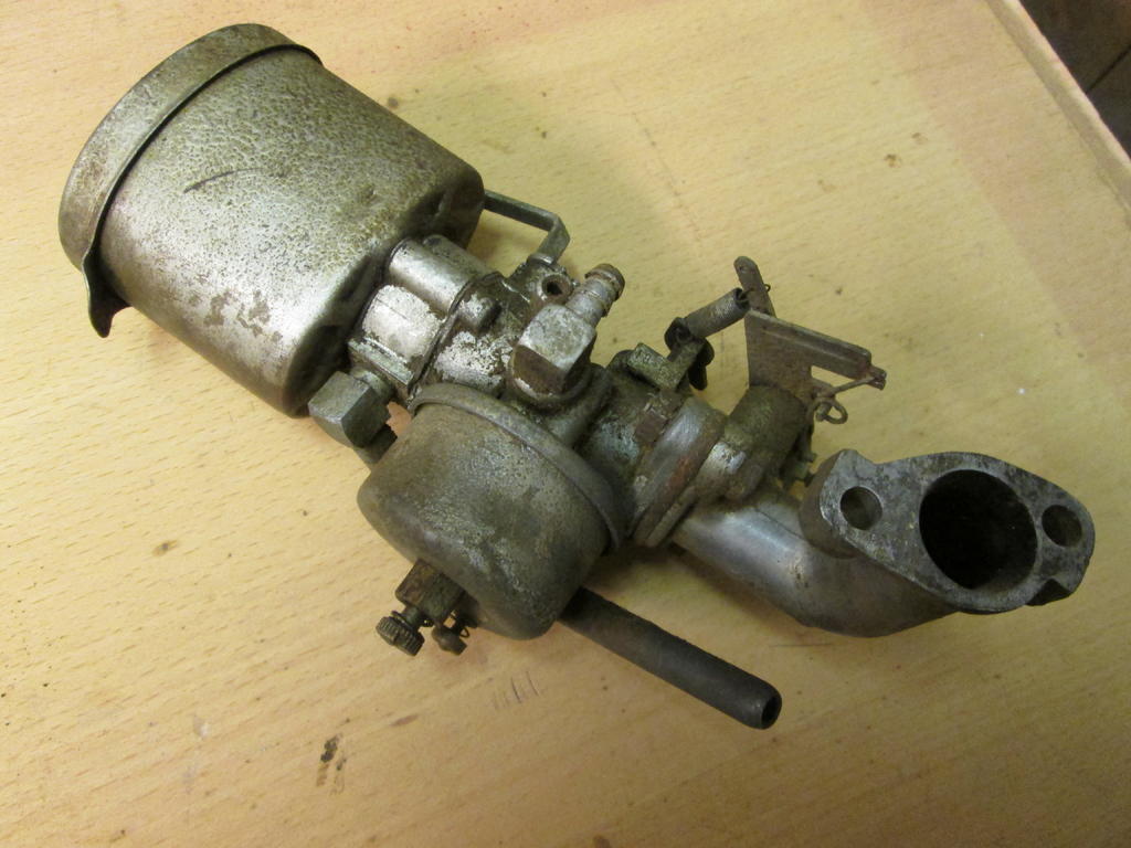

Alan 1,274 #2 Posted November 3, 2017 Hi Pete. Can't be sure of engine model but I saved the carb assembly from a similar scrapped engine. Just taken photo's. A few here. Maybe someone can determine if it would fit your engine. Share this post Link to post Share on other sites
bankman 17 #3 Posted November 3, 2017 Hi Alan, thank you for that but I think that the manifold stud orientation (big word for this time of night!) is wrong, your one seems to be at a lesser angle than mine or perhaps they do sit slightly downwards? Carb etc might be the same though, maybe someone else can shed some light on the matter. Let's see what develops! Pete. Share this post Link to post Share on other sites
