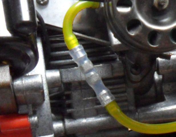

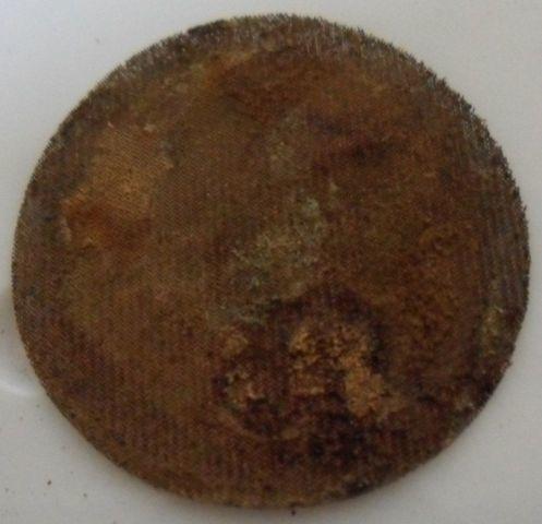

factory 487 #2 Posted February 18, 2018 (edited) The same happened with my first O&R (a Tiny Tor, same as The Tiny Tiger but 240V output), all attempts to unblock the filter failed, I do have a much better technique for cleaning it now. I learnt a lot from that first restoration. I ended up fitting an in-line filter (shown below on a different generator where a previous owner had damaged the tank filter) that was recommended on the previous forum, maybe I should revisit that base tank at some point, I've no idea if the filter can be refitted though as I've never opened one, but I do have some other small tank filters I could use, also I will probably find a leaky base tank eventually. I would use a heat-gun or equivalent to warm up the base & hopefully soften the glue originally used to remove the base, then see if the filter can be repaired. Before refitting the base clean the old glue from the edges of both tank parts and use a fuel/gas resistant glue to refit the base. David Edited March 11, 2018 by factory Share this post Link to post Share on other sites

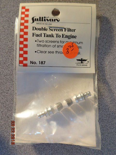

factory 487 #5 Posted February 19, 2018 22 hours ago, Wallfish said: Never had one of those particular tanks apart either but I'm with David, use heat. Torch, heat gun whatever and maybe use a wooden dowel through the fill neck to push it out. Be careful with any tank that has had fuel/gas in recently if using a blow-torch for heat. I was thinking to push the base off with something through the filler neck too, once the old glue has been softened with heat. This is the type of in-line filter (Sullivan No.187) I bought for my engines, picture below borrowed from ePay. David Share this post Link to post Share on other sites

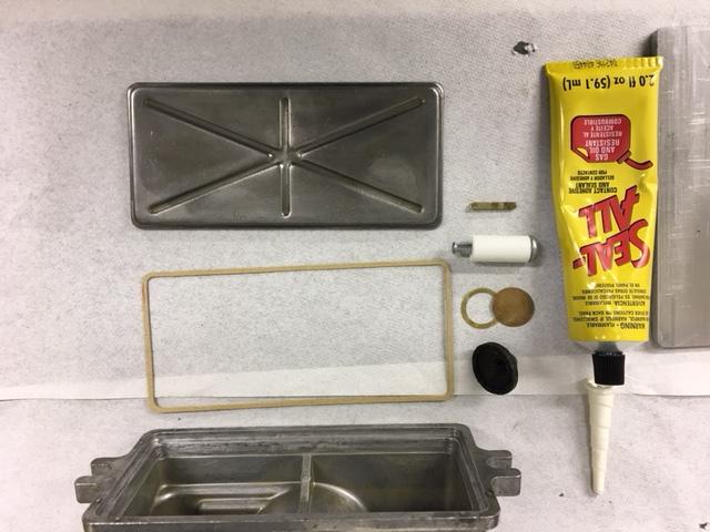

Terry L 3 #6 Posted March 11, 2018 I figured out how to remove the bottom of the Tiny Tiger gas tank and wanted to share how I did this. First make sure all the fuel is out of the gas tank and no flamable vapors are in the tank that could ignite. I used a heat gun to heat the bottom metal plate and the aluminum around the bottom of the tank to about 350 degrees. I was able to use a wooden dowell to push from the inside of the tank push the cover off. The filter on the inside of the tank is rubber and will most likely be deteriorated. I removed the rubber filter and shortened the brass tube about 3/4 of an inch and used a chain saw fuel filter that fit over the tube to replace the disinegrated rubber filter. I made a new paper gasket to replace the original paper gasket for the bottom cover. Pay close attention to cleaning the bottom cover where the bottom cover and the aluminum housing fit together. It must be exceptionally clean for the adhesive glue to seal well. I used "Seal All" adhesive which was recommended by the manufacturer for this type of application. "Seal All" may be purchased at most automotive stores. Apply sealant per instructions on the package and assemble the cover to the tank. I also put a little sealant around the outside of the tank cover after I assembled it. Some people mentioned the use of "Yamabond" which I am sure could be used as well. "Seal All" was only $4 a tube which I believe is cheaper than "Yamabond". I have attached pictures as a reference of how I accomplished this. 2 CNew and factory reacted to this Share this post Link to post Share on other sites
factory 487 #7 Posted March 11, 2018 Well done and thanks for sharing the pictures, I've never seen the inside of one of those tanks before, will have to have a go at replacing the filter in mine sometime. Seal-All seems to be available over here as well as Threebond (Yamabond?), there are probably others that would work if you read through the data-sheets and check how others have got on with them, also check the shelf-life too (seems to be two years for Seal-All). Note; I've removed the reference to epoxy resin from my earlier post as it doesn't look suitable. David Share this post Link to post Share on other sites

rbcfab 9 #12 Posted May 6, 2021 Decided to extend the fuel pickup tube in the tank with some copper tubing and fitting a filter like David describe earlier. I ordered a few RC glow filters but all required larger fuel line. Seems like 3/32 fits the best so hoping that is what the barbs on Sullivan 187 are for. Share this post Link to post Share on other sites
factory 487 #13 Posted May 6, 2021 16 hours ago, rbcfab said: Decided to extend the fuel pickup tube in the tank with some copper tubing and fitting a filter like David describe earlier. I ordered a few RC glow filters but all required larger fuel line. Seems like 3/32 fits the best so hoping that is what the barbs on Sullivan 187 are for. I've been using 3/32 fuel line, it's a tight fit but will go on the Sullivan 187 filters. When I started I had a slightly larger sized fuel line, but eventually found it was a bit loose on the tank & carb fittings. David Share this post Link to post Share on other sites
