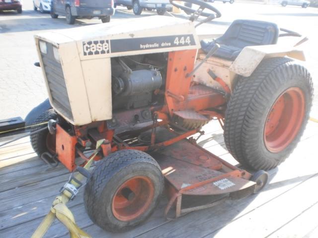

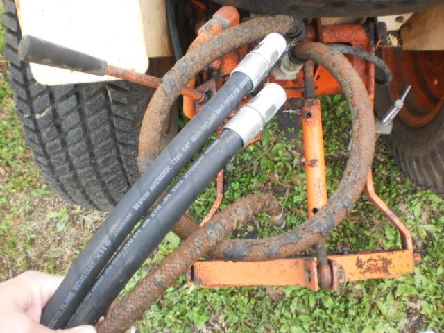

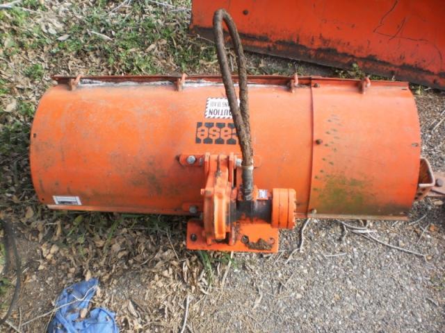

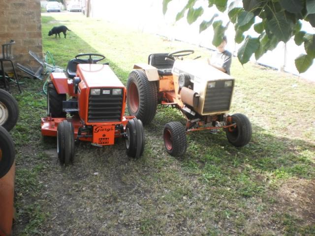

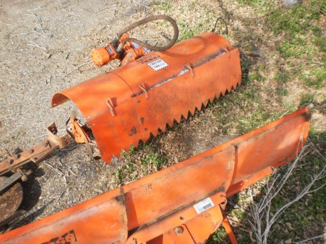

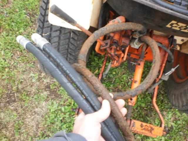

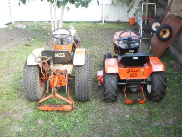

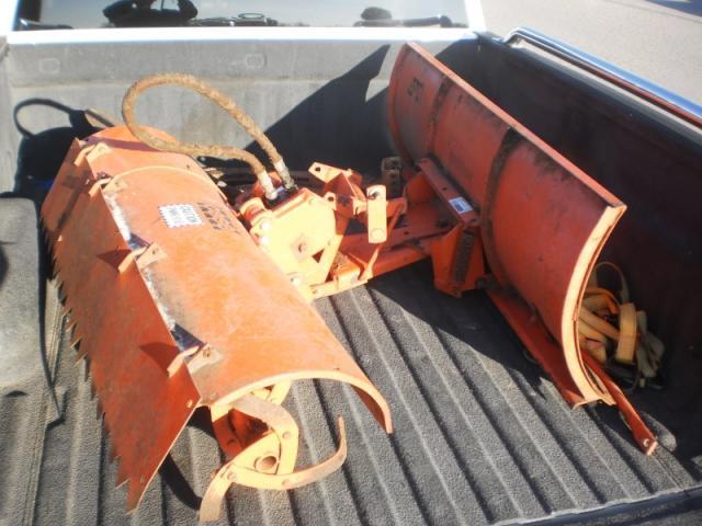

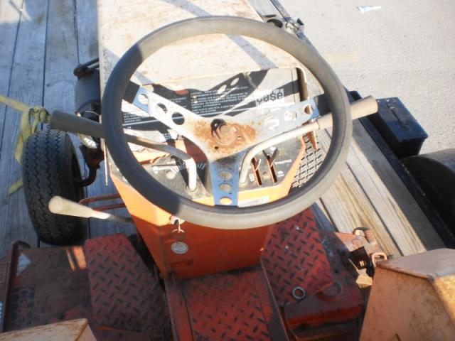

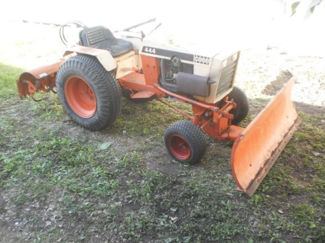

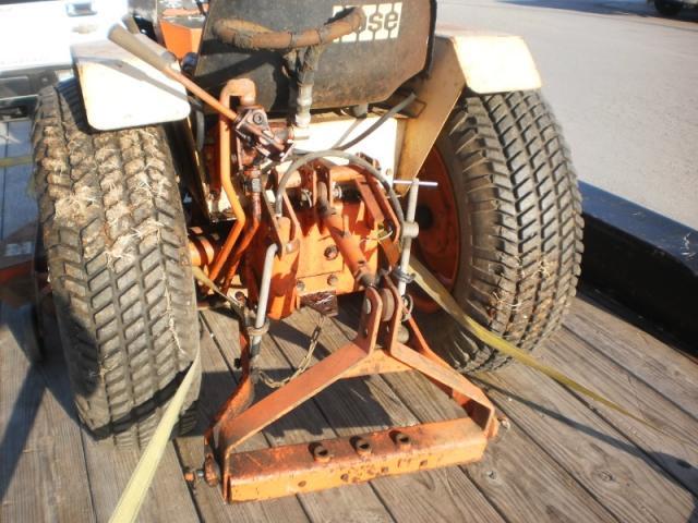

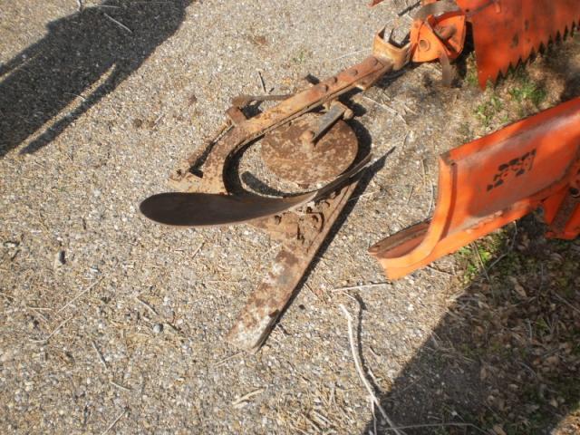

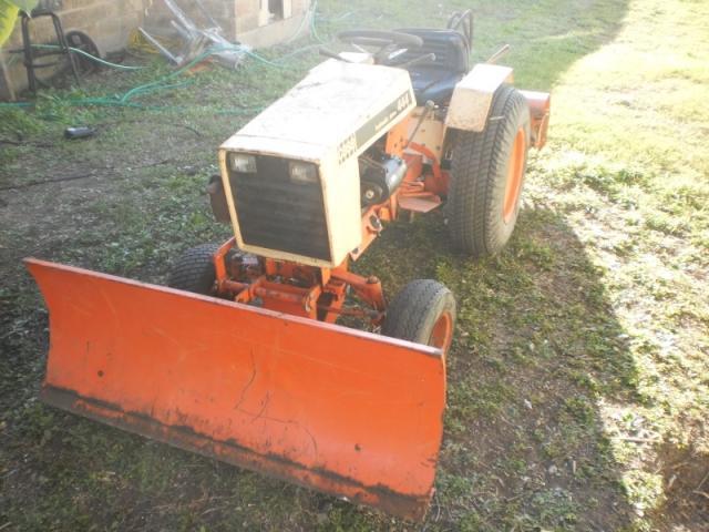

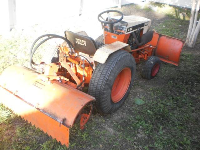

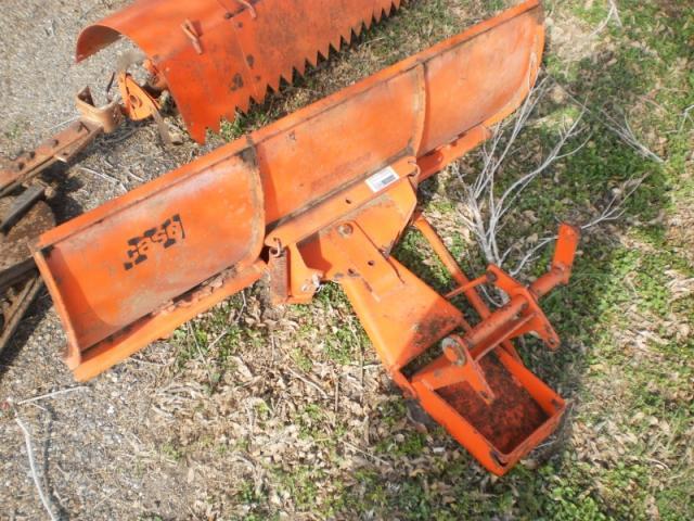

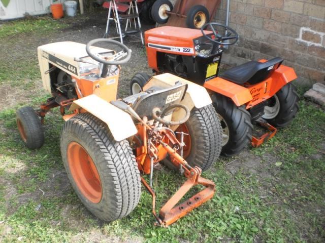

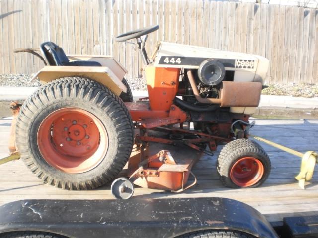

bowtiebutler956 166 #1 Posted February 10, 2014 Hello all. Just thought I'd post a few pics of my latest project. I picked up a 1974 Case 444 Garden Tractor. This is a large garden tractor. It has a hydraulic 3 point hitch, with a hydraulic PTO. I got it with a hydraulic tiller, snow/dirt blade, mower deck, and a very rusty Brinly plow. The starter generator isn't working, so I dropped it off at my local rebuild place to be fixed. The Kohler K321 will need rebuilding, as the previous owner said it smoked, and leaks alot. First, I'm going to get it running so I can check how everything works. I will replace those rotted rear hydraulic hoses before using the hydraulics! I've been wanting a GT with a full 3 point for awhile, so I'm really going to enjoy this project. Here are a few pics from the 9 hour drive yesterday, to pick it up. There is a couple pics of it next to my 222 as well. Matt 3 KATO, Ian and neil reacted to this Share this post Link to post Share on other sites
Ian 2,417 #2 Posted February 10, 2014 That's a great machine Matt, the size of the rear tires give it a GT-14 sort of feel I like the full hydraulics and 3 point. It has all you could need on a small tractor 1 bowtiebutler956 reacted to this Share this post Link to post Share on other sites
pmackellow 2,738 #3 Posted February 10, 2014 Looks like a great project and compliments your other Case, good find !! 1 bowtiebutler956 reacted to this Share this post Link to post Share on other sites

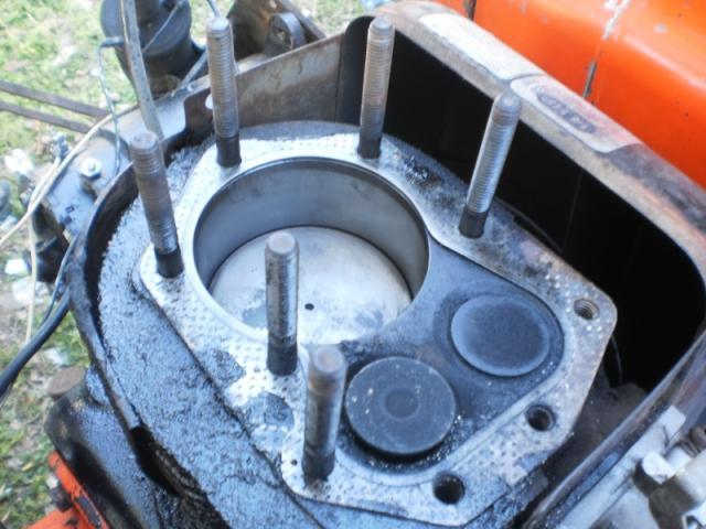

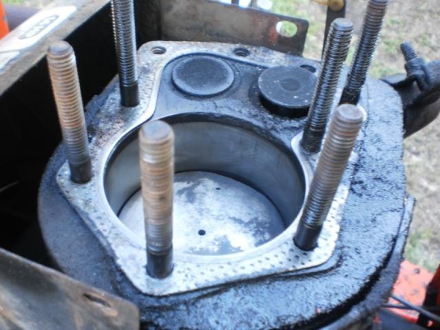

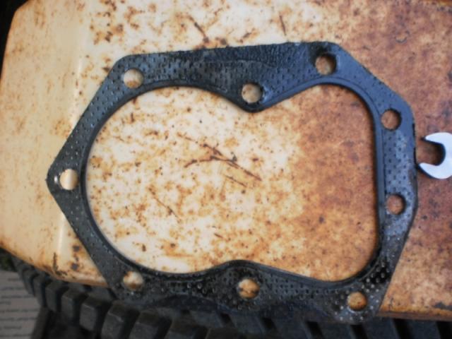

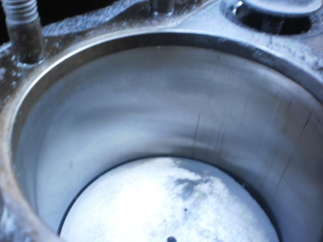

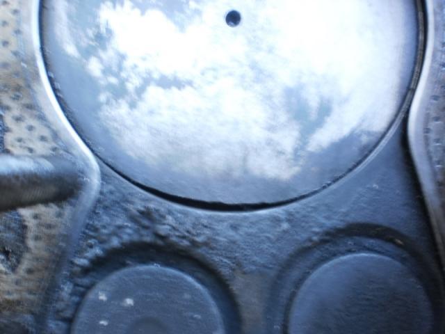

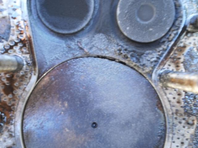

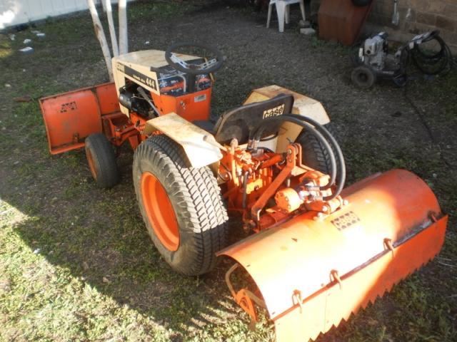

bowtiebutler956 166 #19 Posted February 14, 2014 Thank you guys for the very encouraging words. I got the starter back on the 444 today, and brought it to life. This thing smokes BAD! The previous owner told me it smoked, so I knew in advance. The hydraulics, and drive work perfectly, and I love the way this Beast looks with the blade, and tiller on it. After taking this video, I removed the cylinder head to find a badly blown head gasket, and the crown of the piston closest to the exhaust valve is burned away enough that I can see the top piston ring! No wonder it smoked so bad. However, I'm happy to report the piston is STD, and the cylinder doesn't have any noticeable wear ridge, although there are some light scratches. I might be able to get away with just a hone, and new piston, rings, etc.... I'll know more once I get it all disassembled. Thanks, and here is the video, and pics. Matt Share this post Link to post Share on other sites
Anglo Traction 1,022 #20 Posted February 14, 2014 Late on parade ...me ...Very nice acquisition and Project Matt. A well proportioned Machine and great attachments. That Piston/Bore condition is identical to the one I had to sort out (stalled piston caused by Carbon). You'll soon have sorted, with all 14 horses singing and pulling together !. Look forward to seeing your progress. 1 bowtiebutler956 reacted to this Share this post Link to post Share on other sites
bowtiebutler956 166 #21 Posted February 14, 2014 Late on parade ...me ...Very nice acquisition and Project Matt. A well proportioned Machine and great attachments. That Piston/Bore condition is identical to the one I had to sort out (stalled piston caused by Carbon). You'll soon have sorted, with all 14 horses singing and pulling together !. Look forward to seeing your progress. Your not late Richard, your right on time. I've decided, that if all possible, I'm going to try and leave the bore standard. With the engine not having a wear ridge, and only very mild scratches, it would be nice to leave the cylinder nice, and thick. It would also be nice to have a 40 rear old engine that runs great, and is still STD bore, STD crank. I don't have much of an update today, but I did have something show up in the mail. My new seat! I believe this is the same design use on the later Wheel Horses, and I really liked it. I'm not going to mount it yet, but I set it on top of the old seat for a reference. Thanks Matt Share this post Link to post Share on other sites
