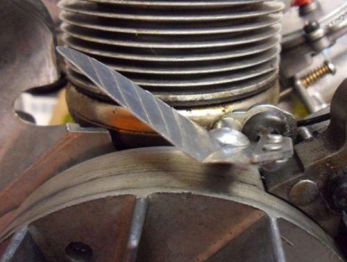

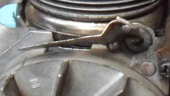

factory 487 #20 Posted April 2, 2019 17 hours ago, Wallfish said: See, David got excited and impressed so much by these little screamers at high rpm he's now the O&R guru. They just don't scream for long enough though, high RPM's soon drain the tank. And yes it did go way way past the normal maximum speed with the vane dislodged out of the carb from the vibrations, it took a few more high speed runs to find the cause. The RC modellers almost always chucked the vane away to achieve a higher RPM too. Here are a couple of pictures of the bent governor vane, that were posted on the old forum. Bent governor vane Repaired governor vane David Share this post Link to post Share on other sites
CNew 408 #21 Posted April 2, 2019 Wow, that’s major! Thankfully I haven’t seen any significantly bent vanes yet on any of my engines. I’ll keep an eye out for it though... Share this post Link to post Share on other sites
factory 487 #22 Posted April 2, 2019 That one is actually an all aluminium governor vane from a .85HP engine and because it was my first O&R I had nothing to compare it to at the time, but I soon found help on the old forum. David Share this post Link to post Share on other sites
