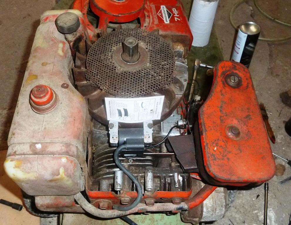

Steve in France 1 #73 Posted December 3, 2022 (edited) Thanks Anglo Traction, that is so very kind. It was a great help and I have found the right manual, which is brilliant. I have ordered 2 new springs. Thanks again. I thought I would have a look at the magneto. Which leads me to my next question, maybe someone could help. this is a pic of the current magneto. It looks like, to me that it maybe an electronic ignition. How can I tell if that is correct. Many thanks in advance. Have great weekend. Edited December 3, 2022 by Steve in France Grammar typos Share this post Link to post Share on other sites
Wristpin 400 #74 Posted December 3, 2022 That’s a Magnetron ( electronic, no points) coil. Setting the air gap by the book - turn the flywheel to move the magnets away from the coil.Loosen the coil bolts and pull it away from the flywheel, tighten one. Turn the flywheel so that the magnets are under the coil armature legs. Insert your non magnetic gauge between the coil legs and the flywheel. Loosen th holding bolt so that the magnets pull the coil to the flywheel. Tighten both bolts and rotate the flywheel while pulling the gauge out. The gauge. I remember that instruction sheet supplied with new genuine coils can be used as a gauge. I use a strip of plastic cut from a milk carton. 1 1 riber3 and Steve in France reacted to this Share this post Link to post Share on other sites
