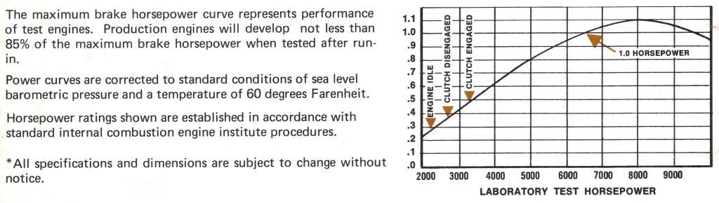

factory 487 #2 Posted August 1, 2019 The 1HP rating is for a nominal speed of 6300rpm. They did do laboratory tests at higher speeds where they obtained a max of 1.1HP at approx 8000rpm, but production engines are stated to not have less than 85% of this (which I calculate to be 0.935HP), of course this will not represent real world conditions. I have posted the BHP curve graph from the AEP Series 13B engine specifications somewhere before, but here it is again. The full 1975 AEP Series 13B engine specifications can be found in the manuals sticky thread here; 1 hour ago, K-TRON said: Am I correct that the model 13B has a 1-1/4" bore, and 1.096" stroke, with 1.34 cubic inch, 21.9cc displacement, rated 1hp @ 6300rpm. All correct, 21.9cc is round down from 21.95867cc (which is converted from 1.34 cubic inches) as far as I know O&R only gave the displacement in cubic inches. David Share this post Link to post Share on other sites

K-TRON 25 #4 Posted August 1, 2019 David, Yes the numbers are stamped on the cooling baffle. There is a sticker on the top of the engine which says that it was manufactured by Advanced Engine Products. Thank you for helping me decode the serial number. I like to hold as much correct information as possible about the engines in my collection. September of 1976 sounds about right to me. The literature and warranty card I have is printed 1970 and 1973, so it only makes sense that the engine was later. I had no idea that they were building thousands of these engines per month. You certainly do not see them very often anymore. The horsepower chart is also wonderful. I have not seen that before. I have the correct air filter for this engine, it is just not installed at the moment. Chris Share this post Link to post Share on other sites
