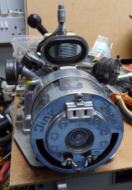

factory 487 #51 Posted November 10, 2019 On 11/8/2019 at 8:51 PM, JUST O&R said: David I WILL AD PICS BUT YES ITS A MODEL B II ser 102646. cylinder is good just trying to make it look like it should if I'm correct it should have a uy-6 in it???? like to make them as close as I can. but sometime we have to make due . I found a cylinder that will work for JD's generator but the crank has two keys in it . its taper but Ive never had one apart so don't know if it will work Apologies for not responding quicker, I've been very busy with family this weekend. Very strange that the Model B engine has the gearbox, I do wonder if a new engine was fitted to the gearbox from another older engine, it should really have a different letter or number to identify the gearbox type, maybe a repair shop never stamped those details, I guess we will never know. It should still be possible to find out the gearbox type by the numbers of teeth on each gear & if there is a clutch fitted (or not). If my information is correct serial numbers around #100000 date from the time that the Compact I, II, & III were available, possibly they were using up stocks of old parts when the updated Compact III engine became available, for example I have SN #099677 stamped as a Compact I with 10mm spark-plug and SN #103001 stamped as a Compact III with a 14mm spark-plug. Hopefully I can find time to double-check both types of tapered PTO shaft will fit during the week or next weekend. David Share this post Link to post Share on other sites

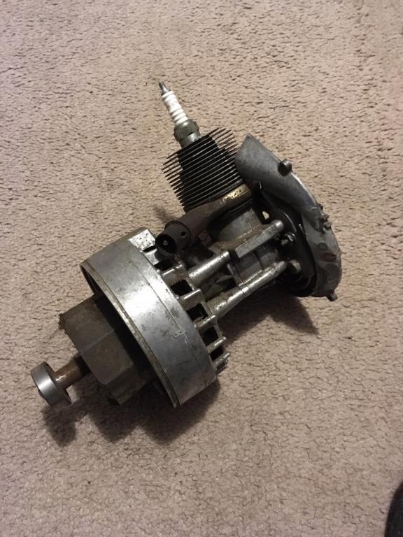

JDB44 0 #57 Posted November 24, 2019 Well finally got around to removing the generator from the crankcase. No I didn't get around to cleaning the work bench! Shaft is slightly tapered. Now to find either parts to rebuild or decent decent crankcase and cylinder. Suggestions appreciated! Work bench will need thorough cleaning and sorting after this! No key way cut in shaft. Share this post Link to post Share on other sites
factory 487 #58 Posted November 25, 2019 22 hours ago, JDB44 said: Now to find either parts to rebuild or decent decent crankcase and cylinder. Suggestions appreciated! I thought you needed a piston, con-rod & bearings, what was the problem with the cylinder? I've cleaned up cylinders with a brake cylinder hone tool. I'm curious as to what state the internals are in, did it fail because of a broken plastic bearing cage or something else? I can't think of any other suggestions that we haven't already mentioned, i.e. finding a donor engine or engine block only. David Share this post Link to post Share on other sites
JDB44 0 #59 Posted November 26, 2019 I think all that is needed is the piston, connecting rod and bearings. Look like the plastic bearing cage failed causing the damage to the piston. Hoping someone here might have what I need. Fearful buying sight unseen from eBay may get a junker in same shape.....or worse. Share this post Link to post Share on other sites

factory 487 #61 Posted November 26, 2019 Now we have a picture that shows the engine serial number (#027xxx) I can tell you that it dates from around the end of 1962. The most appropriate parts list for you engine is the May 1962 one, which can be found here: 18 hours ago, CNew said: I think this is the piston... That piston (#37-5) is for later engines, using it would need a set of wrist pin rollers, wrist pin washers, a change of con-rod and different crankshaft bearings. I still recommend finding a later donor engine, that will provide all the later improved parts, including the upgraded bearings with steel cages, the use of plastic cages was a major design flaw with these earlier engines. I've no idea why they decided they thought the plastic cages were a good idea, as the model plane engines they built before the Compact engines used metal bearing cages. David Share this post Link to post Share on other sites

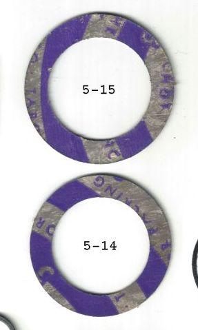

factory 487 #68 Posted November 27, 2019 18 hours ago, JDB44 said: Wallfish, sent you a pm on the piston. Any thoughts on who may have gaskets? Would gasket from my cylinder possibly work or could I make them? These are the cylinder gaskets used for the 3/4HP engine. I have made these using some NOS ones to check the sizes, it's probably not worth buying a sheet of material unless you intend to restore lots of O&R's. Note that the cylinder gaskets are made from thicker material (also more heat resistant) than the induction case gaskets (and once again later engines differ ). Also a new cylinder O ring would be a good idea. David Share this post Link to post Share on other sites

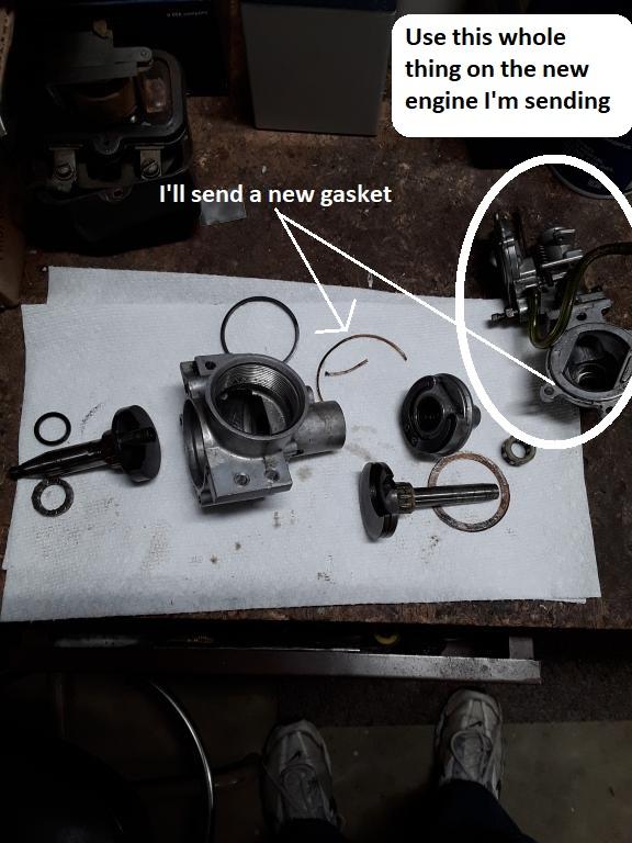

Wallfish 716 #70 Posted November 28, 2019 I'll find you the right parts to fix it. I might have the whole kit and kabootle. Have the holiday day off tomorrow. Share this post Link to post Share on other sites

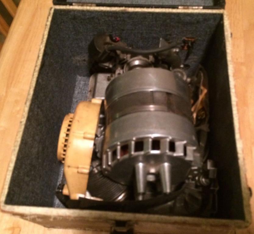

Wallfish 716 #71 Posted November 28, 2019 Got all ambitious and dug through some old stuff and found this. Between the one you have and this you should have enough to get going again. Compression feels good but it probably has the old type plastic cage bearings, but when or if this one fails we'll fix you up again so there's nothing to loose. I'll remove the the generator section unless you need it. One thing for sure, the parts will fit. PM me your address Charlie and I'll send it to you. No charge because I have no idea of the full quality of the parts inside. BUT you have to post some pics and tell us how you made out. Type 111 SN 034701 Share this post Link to post Share on other sites

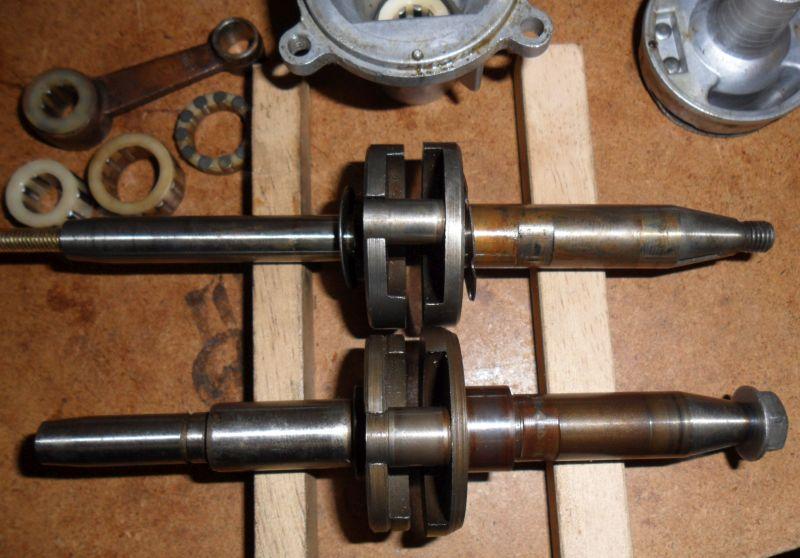

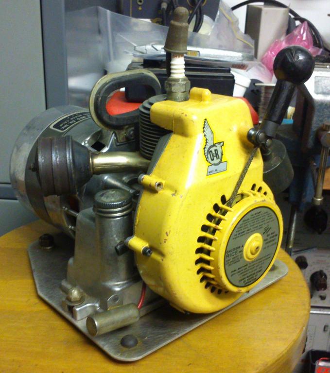

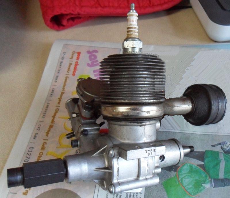

factory 487 #72 Posted November 28, 2019 (edited) That looks like a good donor engine , I used a bare engine block of similar age for my TT repair*, that ensured the parts would fit together with the remaining original parts. *My failed TT engine was SN #035753 (Type 111), it was bought as a pile of bits, it was missing the crankshaft, piston, con-rod and con-rod bearing. The donor engine block was #012461 (Type 98) which had been used for a RC application by a previous owner, hence lots of missing parts. Before & donor engine. Some pictures from the restoration, it's also the only TT I have with the generator end housing finished in chrome. One of the missing parts was the long truss head screw for holding the generator rotor in place, a new one was machined from scratch, OK I deliberately made it a little bigger in places. David Edited November 28, 2019 by factory 1 CNew reacted to this Share this post Link to post Share on other sites
