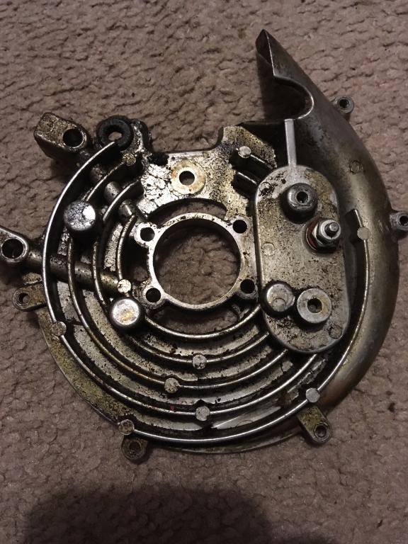

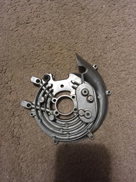

Wallfish 718 #1 Posted January 14, 2020 So far I'm a big fan of using the citrus degreaser. It doesn't stink so it can be used in the house. This allows me more opportunity to get stuff done during the winter months and late in the evening. It works well for cutting through the common 2 stroke oil grime on these engines and attachments. This engine plate was done late last night in my office, going out to do it in the shed is a big hassle and cold so it won't happen. It took about 15-20 minutes using paper towels and some Q-tips. I use a small bucket to spray over and the small parts thrown in the bottom get soaked by the dripping excess at the same time. I have an old gas tank with old gas and that stink so I'll try that outside and see what happens. Hopefully neutralizes that horrible stink. BEFORE AFTER. There's still some minor little spots in the nooks and crannies but that happens with solvent too. Typically I'll use a toothpick to scrape those clean. The wood doesn't scratch 2 Triumph66 and pmackellow reacted to this Share this post Link to post Share on other sites
