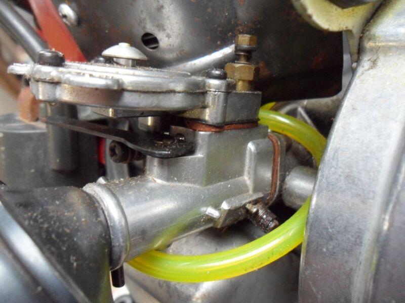

factory 487 #78 Posted July 23, 2020 Can you add some pictures of the carb from your Tiny Tiger, they vary quite a bit depending on the age, early ones don't have the little adjustment lever for example. David Share this post Link to post Share on other sites
art faulkner 0 #79 Posted July 24, 2020 It is model #111 sn #023390 the idle adjustment is on top of carburetor between diaphram and motor, it is a small spring loaded lever that adjusts the govenor, located on the side of the carburetor, the serial # of the power unit is 07461, the unit runs fine, and generates but need to control rpm, tks Share this post Link to post Share on other sites
CNew 408 #80 Posted July 24, 2020 I don’t think I’ve ever seen one of those governor arms by itself as a spare part, although I’m sure they were sold that way at one point in time. Or, you could maybe consider a setup kind of like this. I have an engine that has a small throttle linkage in place of the arm, probably from some sort of R/C application. You could do this and add a cable or arm to control the throttle. Share this post Link to post Share on other sites
art faulkner 0 #81 Posted July 24, 2020 good idea, bought this tiny tiger 8 years ago for $50 , it has the original box and paper work(not prime condition) I may buy a junk unit to get the arm. the other thing that concerns me, since there is no voltage regulator, rpms control the voltage? the instructions say to hook up to 300 watt light bulb and adjust the idle screw to maintain that value. tks Share this post Link to post Share on other sites
factory 487 #82 Posted July 24, 2020 16 hours ago, art faulkner said: It is model #111 sn #023390 the idle adjustment is on top of carburetor between diaphram and motor, it is a small spring loaded lever that adjusts the govenor, located on the side of the carburetor, the serial # of the power unit is 07461, the unit runs fine, and generates but need to control rpm, tks Earlier engines fitted to Tiny Tigers such as yours (#023390) & mine (#036839, picture of carb attached) don't have the governor adjustment control lever. If you want to add this then searching for a later carb is the only answer, just be aware there are two different springs used over the years depending on the governor vane size. 5 hours ago, art faulkner said: the other thing that concerns me, since there is no voltage regulator, rpms control the voltage? the instructions say to hook up to 300 watt light bulb and adjust the idle screw to maintain that value. tks That part with the 300 Watt load is to set the needle valve, not the idle stop screw. David Share this post Link to post Share on other sites
art faulkner 0 #83 Posted July 24, 2020 I do not understand how the governor vane works. the flywheel vanes produce a air stream that engages the governor vane and activates the throttle via the spring(rod) this appears to be a fixed and nonadjustable value. so if I set the needle valve at the 300 watt value, how does the governor vane function in this situation. My guess is at some rpm value the governor would be static and if the motor loads up , the air flow to the vane would drop allowing the throttle to open to maintain that value. tks Share this post Link to post Share on other sites
factory 487 #84 Posted July 24, 2020 Correct the early governor vane without adjustment will operate the engine at a fixed speed. As a consequence if the generator only has a small load then the voltage will be a higher than with a full load, this won't bother equipment designed to operate over a wider voltage range (check appliance labels), but will shorten the life of filament lamps due to the higher voltage (they will run brighter though). David Share this post Link to post Share on other sites
