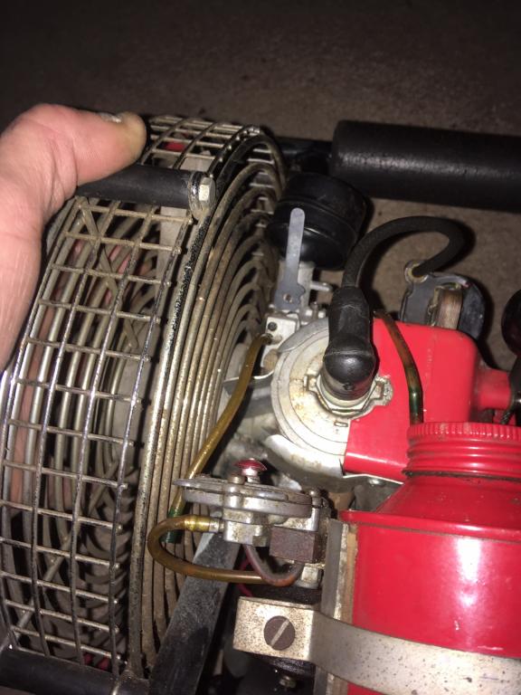

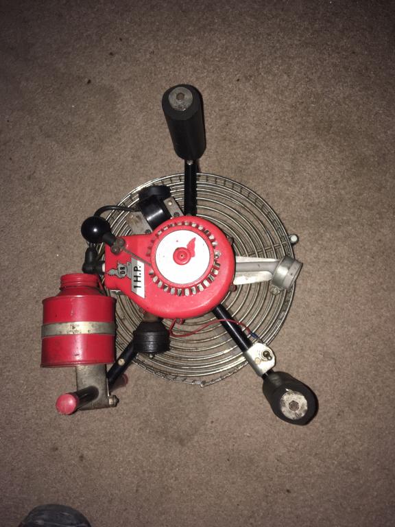

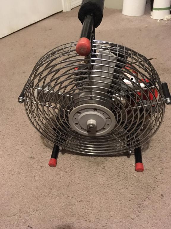

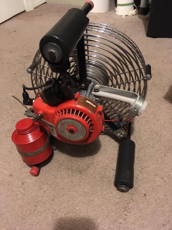

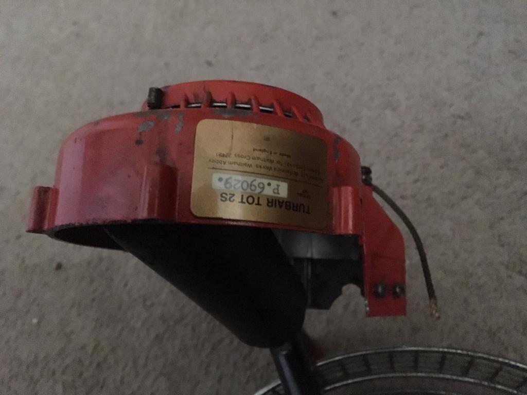

Wallfish 717 #1 Posted February 16, 2020 Trying to keep up with JUST O&R is a real pain! This just so happened to be the closest box on the shelf but have been intending to get to this one. I have the correct recoil cover with the label and the chrome could use some cleaning. I'll dis-assemble the entire engine and unit to clean and freshen everything up. These are cool little insecticide spraying fans from across the pond. 3 CNew, JUST O&R and pmackellow reacted to this Share this post Link to post Share on other sites

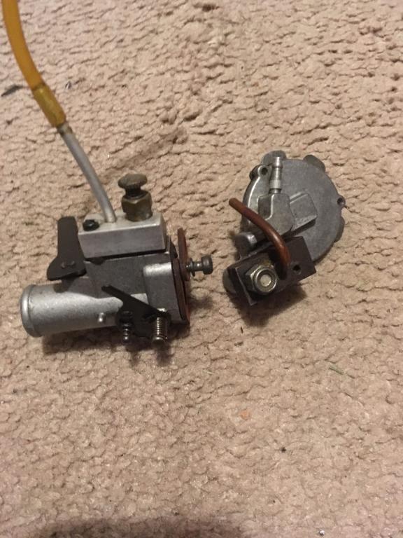

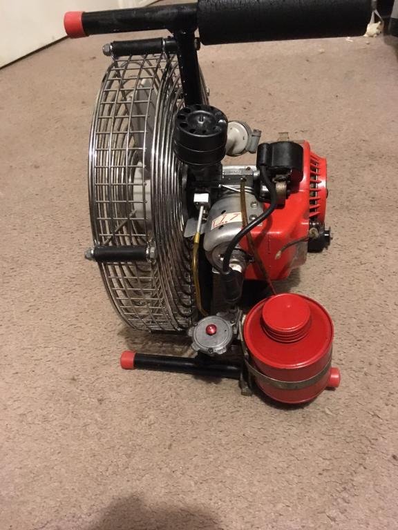

Wallfish 717 #2 Posted February 16, 2020 Almost forgot about this unique and very interesting feature of these things. Notice where the diaphragm section of the carb is. It's not connected to the carb body and feeds fuel remotely through a fuel line 1 CNew reacted to this Share this post Link to post Share on other sites

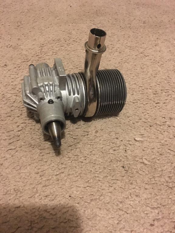

Wallfish 717 #5 Posted February 16, 2020 I got the fan blade off fairly easy by doing it like a flywheel. Loosen the bolt, hold the blade and hit the bolt with a rubber mallet. Did have a hard time getting that piece which holds the frame off of the engine. @factory David, what's the difference between a model 176 and 186? Thr Turbair is a 186 but I have a NOS real nice engine 176 which is a glow plug conversion. Just remove the glow plug and I can swap all the other engine pieces. The only real difference I think is the crank end. The 176 is tapered with the keyed grooves and the 176 is just tapered. The connection does not require the keyed grooves. Probably just swap it anyway. Share this post Link to post Share on other sites
CNew 408 #6 Posted February 16, 2020 Those fans are so cool, hoping or of these days to find one. Interesting carb set up, I’ll have to study that one a bit more.. Share this post Link to post Share on other sites
Wallfish 717 #7 Posted February 17, 2020 You guys need to kiss David's @@@ because you may need someone to send it to you. And @pmackellow Paul's too. I had 2 sent over and sold one to Jim, @usedtoolman. Which reminds me, I need to get a hold of him and get him to participate on here again. Very smart and knowledgeable guy. Maybe the only 2 in the USA? 1 hour ago, CNew said: Interesting carb set up, I’ll have to study that one a bit more. The carb itself is not special at all. It's the parts they made to fit and do that is what's special. Fairly simple too. They moved it so the fan parts fit closer to the engine as the diaphragm section would've hit. Share this post Link to post Share on other sites

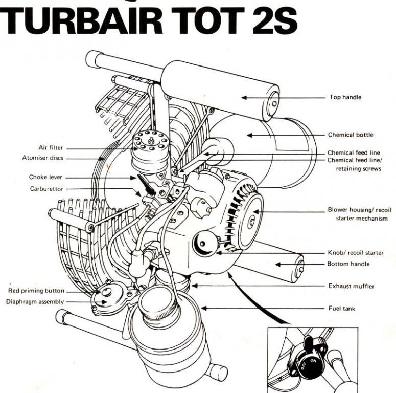

factory 487 #8 Posted February 17, 2020 21 hours ago, Wallfish said: David, what's the difference between a model 176 and 186? Thr Turbair is a 186 but I have a NOS real nice engine 176 which is a glow plug conversion. The Type 186 is used on my Turbair sprayers too, sadly the service manual lacks a parts list for it, but does have the type 176 (I have a pump with a type 176), the differences are going to be the type of gas tank supplied, the mounting flange with the extra threaded holes and the carb parts used (they also remove unused parts from these lists). I also have an engine from a later 13B version, this one is a Type 13B338, the sprayers should have a choke lever label on the large cylinder cooling baffle. And finally everyone of these sprayers I've seen has the spring removed form the carb idle screw, which is then screwed all the way in, as shown in the manual too. David Share this post Link to post Share on other sites
Wallfish 717 #9 Posted February 17, 2020 Thanks David, Already swapped everything over to the 176 and almost done with it. The only difference I noticed was the crank end Share this post Link to post Share on other sites
Wallfish 717 #10 Posted February 18, 2020 They go quick when there's a nice new engine available for it. Just need to finish the recoil but I'll do 3 or 4 at a time because once you get go'n on them it just seems to go smoother. The chrome on this cleaned up nice. (probably get cancer from the crap that was inside from the chemicals run through it.) Here's a close up pic of those carb adapters 3 pmackellow, factory and CNew reacted to this Share this post Link to post Share on other sites
CNew 408 #11 Posted February 18, 2020 Wow, that turned out really nice, almost looks new! You turned that one really fast, giving Just O&R some competition... Share this post Link to post Share on other sites
Wallfish 717 #12 Posted February 18, 2020 It was already in decent condition, new engine available and not really too many parts on those Kinda neglecting my duties up here in the office work'n on engines for hours instead doing actual work Share this post Link to post Share on other sites
