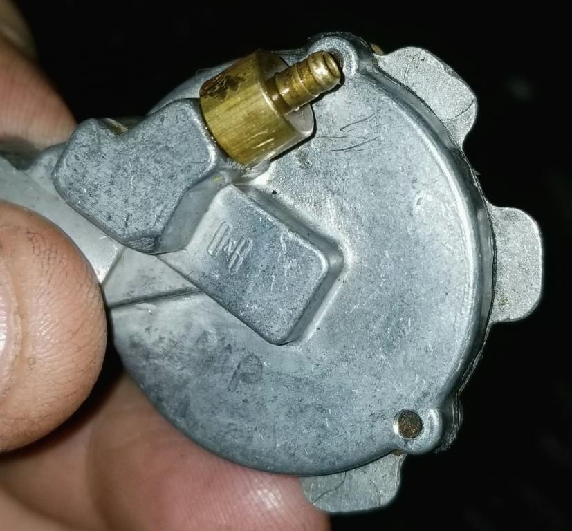

Brian Lynch 19 #1 Posted February 16, 2020 Hi all, First post. Not a small engine newbie, been in the field for close to 45 yrs. Had wrenches in my hands since I don't know when. Dabbled in bikes, sleds, mowers, etc. when I was young. Worked for a Wheel Horse dealer for 3 yrs, then went to John Deere for 10 yrs. Freelanced for another 15 with my own brick & mortar shop. Left the small engine repair business in 2012 but still keep my finger on the pulse of what is new. Recently I had a friend drop off a Drillgine to get running. It's in very good shape, has a 13B engine. My question pertains to the brass object attached to the diaphragm chamber. Is this a fuel filter or a check valve? Can't get any fuel through it. It looks like someone either tried to remove it at one time or replaced it.. The rest of the carb is in excellent condition. Thanks for your help! -Brian Share this post Link to post Share on other sites

Wallfish 714 #5 Posted February 17, 2020 No. DON"T use carb cleaner in it. It's a check valve with a rubber type of flapper inside and carb cleaner will swell it closed and locked. Hopefully I'm not too late. BTW Typcally you can push it open with the flat end of a paper clip or better yet the butt end of a drill bit that just fits inside but you gotta go easy and feel for it. Then try and blow through it to see if it's loose. Once loose you can use something that won't swell the rubber. I've been using citris degreaser for cleaning my engines recently and it disolves that old 2 stroke oil pretty good. Never tried for that but if you can keep pushing that stuff through eventuality it should clean it. then check the valve by blowing the other way and you should'nt be able to. then go back and blow and hopefully you're all set. When all else fails, drill a hole through it using that drill bit you tried with earlier. That's what I had to do after carb cleaner Share this post Link to post Share on other sites

CNew 408 #8 Posted February 17, 2020 8 minutes ago, Wallfish said: No. DON"T use carb cleaner in it. It's a check valve with a rubber type of flapper inside and carb cleaner will swell it closed and locked. Hopefully I'm not too late. BTW Now you’ve got me curious, how does the little valve work inside that brass nipple? I know the little lever/plunger inside the carb seals it up with the little rubber piece in place of the little steel check ball like on the other style carbs but I can’t think of how an additional valve inside the brass nipple would be activated. Share this post Link to post Share on other sites

factory 487 #12 Posted February 17, 2020 20 hours ago, Brian Lynch said: My question pertains to the brass object attached to the diaphragm chamber. Is this a fuel filter or a check valve? Can't get any fuel through it. It looks like someone either tried to remove it at one time or replaced it. The only fuel filter should be in the gas tank, early engines had another fuel filter in the carb, which was found to clog so often that they removed it. The first one of those check valves I came across was stuck too, all my usual cleaning methods failed, but several KW of ultrasonic cleaning* at work fixed it. David *Sadly the ultrasonic cleaner at work was removed a few years ago, as they wanted the space for other work. Share this post Link to post Share on other sites
Fishnuts2 22 #13 Posted February 18, 2020 I have one of these valves on my Orline saw project. It was plugged up just like most I guess, so I put it in the ultrasonic cleaner for a long time with Simple Green in it. It didn't change anything so I took a drill bit the same size as the inlet and drilled through it just using my fingers to twist the drill. Upon close inspection it shows two piece construction, but in trying to get it apart the assembly pulled out of the diaphragm housing. So I cleaned it the best I could and heated the diaphragm housing up to 150 degrees and pressed the brass housing back in place. My carb has the rubber stop on the metering lever too, instead of the small ball valve. I wonder if those were used in combination for certain applications. Share this post Link to post Share on other sites

Brian Lynch 19 #15 Posted February 19, 2020 Tried using Simple Green. It removed some debris but not all. Then on to vinegar. Nope, no results. Next was 2 psi of air pressure. Nope. Figured it was a lost cause. It got the drill. Back together and it's running. Started quite easily, maybe 6 pulls after pushing the primer button. Thanks to all for the help on this. My friend's eyes lit up when he saw it running. On to the next project...I think I've got a mid 60s vintage O&R around here somewhere... 3 factory, CNew and Wallfish reacted to this Share this post Link to post Share on other sites
